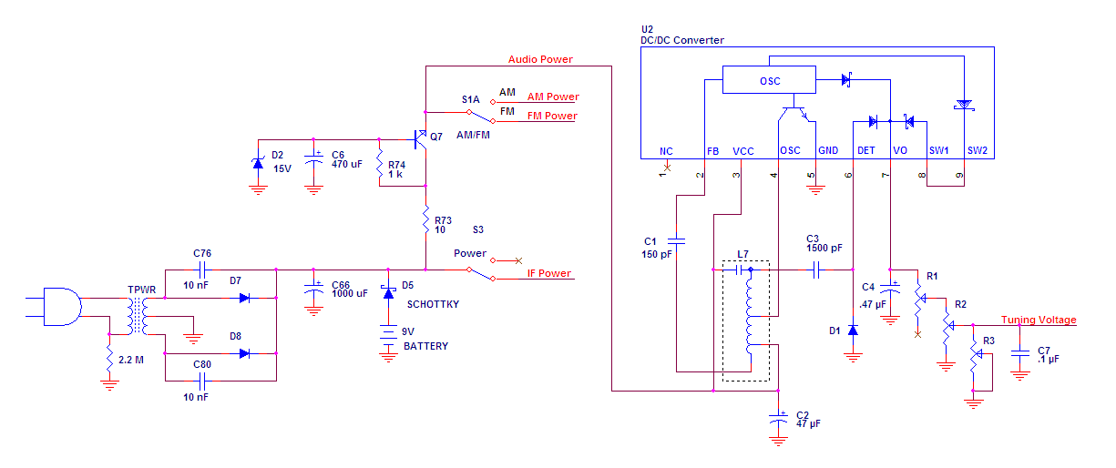

Hi everyone, I'm new on the forum
I'm not that skilled with electronics and I would like to power a radio (it's a GE Superadio model) from a car battery. The radio circuit has 12V but the radio works either on 110V or on batteries. I was thinking about soldering wires after the transformer to feed directly with 12V DC while the radio is unplugged. Could this be possible ?

Hello,
Looking at the page, the used battery seems to be 9 Volts.
Are there 6 C or D type batteries in the battery compartiment?

The schematic for the power supply in the post #3 link shows a 9V battery. You would need to check that all components in the radio are rated to handle a minimum of 12V. You also might need to adjust transistor bias voltages at various points in the circuit to cope with raising the supply from ~9V to 12V. Note that 12V is only a nominal value for a car battery: it might well be around 14V when the battery is in use in a car with engine running.

It takes indeed 6 batteries. I also didn't realize that a car battery would have variable voltage. I'm thinking of a way to power the radio for longer periods at a remote location where there is no electricity, if possible without its batteries.

You could use an analogue voltage regulator, or switch-mode DC-DC converter, to drop the car battery voltage (say12-15V) down to a fixed 9V to run the radio safely within its existing ratings. Such a DC-DC converter, if of low quality, might introduce undesirable noise though.

Much appreciated the answers, I'll look into a converter to attach and wire directly to the rear battery compartment as suggested.
Hold the phone!
Looking at the schematics you've provided, it turns out that your radio already has extensive power conditioning built in, including a voltage limiter (Q7 etc.) and a switching converter (U2 etc.). Nothing further should be necessary and a direct connection to your car battery (e.g. to the "+" end of C66) should work fine.

^ I'd still want a low voltage cutoff circuit to not excessively drain the battery.
