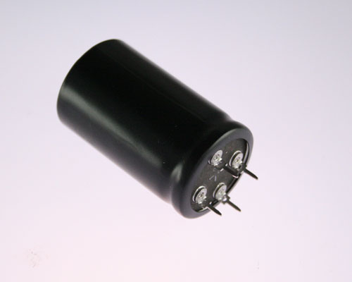

Hello all
I'm new to this kind of thing, so please bear with my ignorance.
In order to avoid smoke-powered computing I'm replacing all the electrolytic capacitors in this 40-year-old PSU, as they seem to be originals. However, the biggest such capacitor in the PSU is proving very difficult to find, and I only need two or three of them, not two or three thousand!
The casing has the following printed on it:
B43306-E0227-T
220 uf an1 +50/-10%
385V-
-40...+85°C 03.85
DIN 41238
Siemens doesn't seem to be making these any more so I'd be most grateful for any suggestions as to what would be a suitable replacement for it.
Thanks in advance for any help and advice.

just get another cap same value, same or higher voltage rating :)

For me it isn't quite as simple as that, as the existing capacitor has multiple pins (four or five) and I lack the knowledge to determine which pins do what. I'm aware that two pins at least are probably there to support such a bulky package reliably, but which two?
As this capacitor is no longer manufactured (at least by Siemens) I haven't been able to discover this information.
show some well lit and sharp photos
you will probably find that several of the pins are just mounting pins to the PCB

@davenn: The cap is still on the board as I don't want to start removing components before I have replacements to hand, so pictures of the pin side aren't possible at present. I attach a picture of it in situ but I suspect that it won't add any new information.
@bertus: The picture you posted does look very much like the kiddie, but the vendor is in the US and I'm in the UK. If I can't locate these capacitors for a sensible price over here then perforce I will have to source them from abroad. I was just hoping to avoid the lengthy wait imposed by transatlantic mail services.

@bertus:
Unfortunately the cap you mention is an axial component, and I require a radial one. It looks as though I'm going to have to bite the bullet and buy from the tedss.com site, delays and all.

Hello,
The datasheet i posted shows wich pin is positive and wich pins are negative.
Even an axial capacitor would be possible to use.
The positive can go through the pcb and the negative lead can be extended by soldering a wire to it and put the wire in the negative connection hole.
Bertus

@davenn: Please see attached photo of the underside of the board the capacitor is soldered to.
@bertus: I'd be grateful if you would confirm that I've labelled the pinout correctly according to the PDF you kindly supplied. The solder pad in the middle of the terminals has no pin in it, so I'm assuming that it's empty/not connected.
I didn't realise that I could change the package of the capacitor - I thought that such things were written in stone at the design stage. This will make obtaining an equivalent capacitor much easier - many thanks.
@Harald Kapp: Thanks for the tip about insulating the wires if I use the axial option. You mention two approaches - insulated wire and heat-shrink tubing - is there any reason to prefer one over the other? I can do either.

I notice that the tolerance for the KON22145 component is +/-20%, whereas the original capacitor is +50/-10%
Is this something I should be concerned about?
The printed nominal capacitance value, is not the actual value capacitance and will vary depending on circuit frequency. As long as you’re working voltage (WV)is the same or more than the original specifications. You have nothing to worry about you are well within tolerance.
