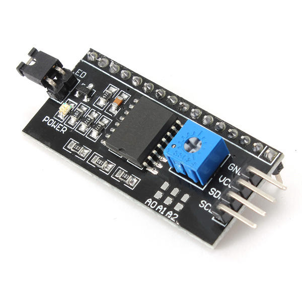

*edit* This does in fact work with 20x4 displays.
http://www.banggood.com/IIC-I2C-TWI-SP-Serial-Interface-Module-Port-For-5V-Arduino-1602LCD-p-80365.html?p=NY231218164622015065
Display used: http://www.banggood.com/5V-2004-20X...-Arduino-p-915064.html?p=NY231218164622015065

I soldered on a header and attached the display to the adapter. Loaded a sketch and modified it so it would show on all 4 lines.
It works. I also replied to the post on the Banggood forum along with the image.

Good to hear. Does it truly address all 5 lines separately? Your picture could have been created even if only 2 lines are addressed correctly and the other two are mirrored. Try 4 different texts, just to be on the safe side.

True. I will do that later and post the results. I did take my clock sketch and just copy and paste the lines then change the row number.

I changed the sketch to verify that the display is not repeating itself. It is indeed working with a 1602 I2C interface. Disregard the temperature part of the sketch.
Here is the code I used...don't laugh...o_O

Very well, that FAQ was most misleading then.
