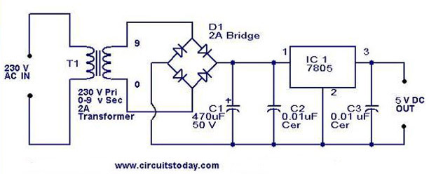

Can anyone send me a pic of a 78XX IC together with the supplying one phase diode bridge recifier please!!!

Hi Chris,
Here's a simple circuit which steps down 240 VAC to 9VAC. Its converted to DC using a single phase bridge rectifier. The DC is then regulated at 5V using the 7805 IC.
