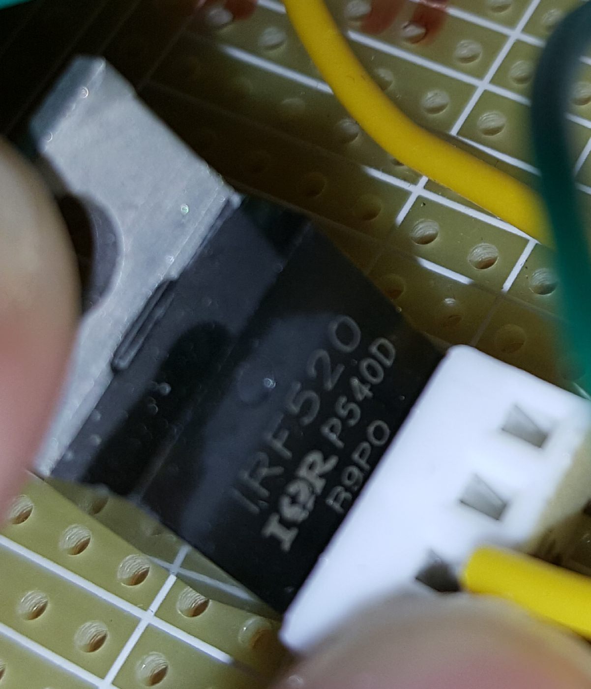

Let me preface this by saying I am not an electrical engineer of any sort. I'm working on a small-scale automation project (Arduino) with a local college. I'm supposed to be doing software, but the responsibility of electronics has kind of fallen to me as well, because my peers consist mostly of intimidated biologists.
I can't find this exact MOSFET part on Google, but we need another one. What I want to know is either 1) where can I find this part or 2) where can I find a part that can do the same thing? I know the voltage/resistance can vary even amongst IRF520s, so that's why I'm asking.
(http://imgur.com/hcslXg8)
Sorry for ugly fingers, I had to bend the connector back a bit (yikes). I'm pretty sure the text says:
IRF520
I[symbol]R P540D
B9PO
Thanks for helping a novice like me, means a lot.
(*steve*)
¡sǝpodᴉʇuɐ ǝɥʇ ɹɐǝɥd
Jan 21, 2010
25,510
Jan 21, 2010
25,510
The IRF520 is a relatively old school MOSFET.
It's rated for a maximum voltage of 100V, a maximum current of 10A, and has a channel resistance up to about 0.25Ω. As an old school device it also has a relatively low gate charge.
My question for you is "what are these used for?"
There are many possible replacements, but knowing what you're switching, voltages and currents for the load, and what is driving the MOSFET will all be helpful.
If you have a circuit diagram that would also be very useful.

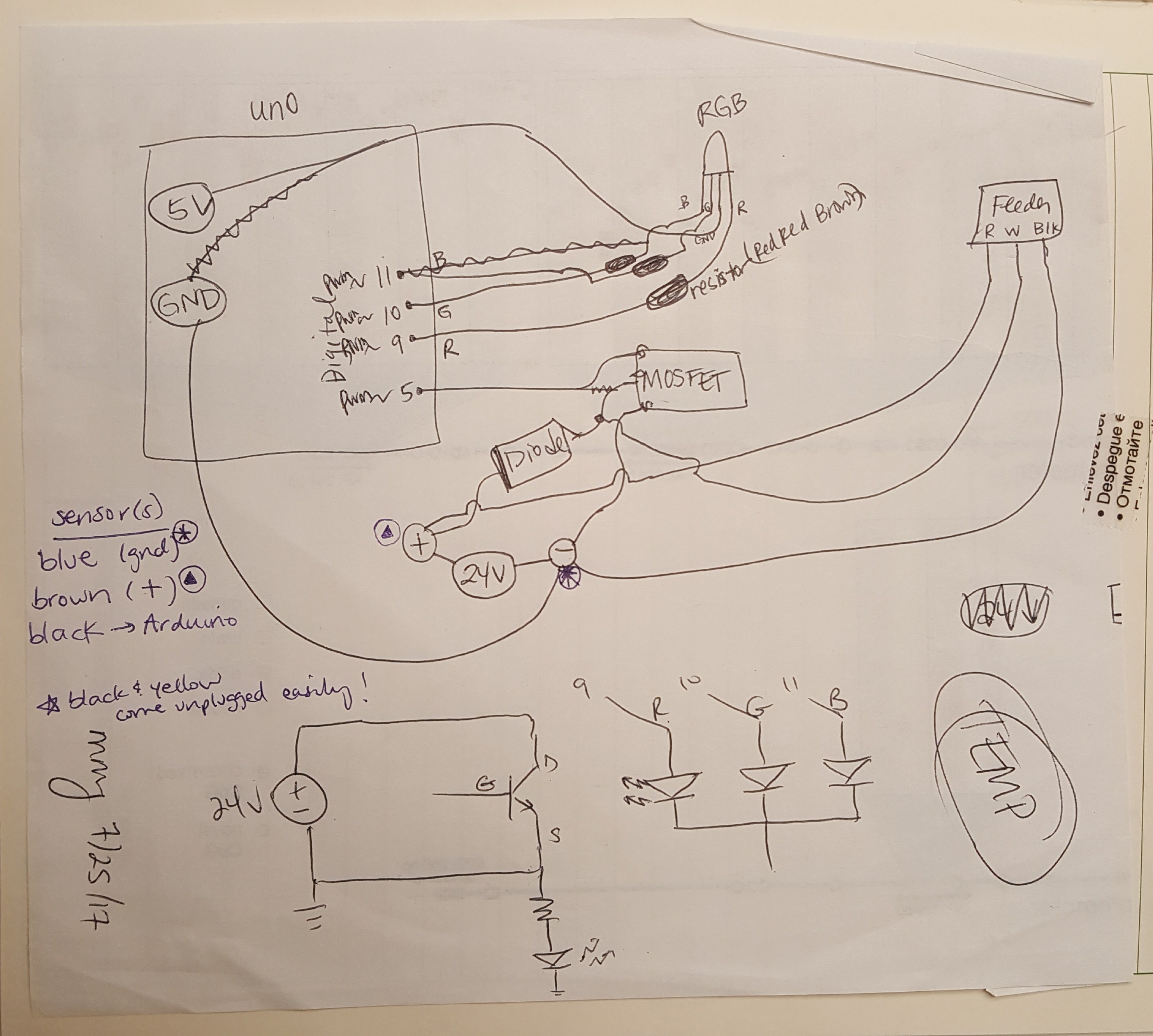

On my end, the project I'm on consists of maintaining an Arduino machine that will feed fish, and will flash an LED when food is ready.
Looking at the code from the Arduino, it seems that the MOSFET is being used to turn the feeder part of the machine on/off.
Code:
void dispense_food()
  digitalWrite(mosfetPin, HIGH);          //dispense food
  delay(500);
  digitalWrite(mosfetPin, LOW);           //reset feeder switch
  delay(500);
On the feeder's listing page, it's noted to use a "28V DC stepper motor." Arduino electronics use around 5V most of the time, I think. (The machine also gets plugged into the wall. )
The people who worked on this before me (and actually built the machine) didn't leave much behind, and are extremely difficult to get in touch with this time of year. But, they did leave a rather old, very sketchy circuit diagram conspicuously labelled "TEMP" in large letters. Not sure if it'll be any help.
(*steve*)
Jan 21, 2010
25,510
Jan 21, 2010
25,510
Let me tell you that the diagram, while terrible, tells me enough :)
I'll let you do the searching. Once you've done that, post a link to what you've decided and we can check it out.
