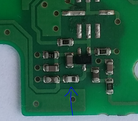

And here is one more..it looks like diode, but it is white and without any marking on in...what is that part ?

not familiar what a black and white one like that
have you measured it with a multimeter on Ohms ?

With continuity test there are short from both sides, resistance from both sides is 0,03 Ohm, and no capacitance. So maybe this is fuse ? If yes, then how to know rated current and why there are marking like diode on it ?

not to be smart,but is 0,03 Ohm resistance the resistance of probes(multimetar)

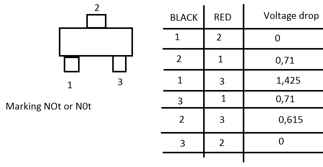

And one more, on SMD transistor-like part there is marking "NOt" . I guess that is TN0200T N mosfet or BFR505T NPN transistor. But how to know exactly ?

Hi again. I have problems with that smd part, marked NOt ( maybe N0t ) . I thougt that there is one of two mentioned parts in #12 post, but now i think i was wrong. Measured all combinations with multimeter, please help identify thata part , thanks !
