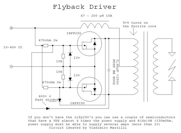

I tried to run it with the ZVS, i dont know how much Amps are going into the Coil, but all i know is that theres going in more than 100V. Im saying more than 100, cause i measured the voltage of the secondary coil on the Flyback core a long time ago, and i dont really remember what it exactly was, but i remember it was over 100V. Ive made the secondary coil on the flyback core from a thin wire, which i dont know the gauge of, but its 1/4 the size of a toothpick ( with its insulation on ). The switching frequency has to be REALLY high, cause when i allow it to arc over, the arc is wery high pitched. I dont have a REAL purpose for it, its only a high voltage Power Supply.

Also, is there a way i can decrease the switching frequency of the ZVS driver to make the arcs longer ? the mosfets are IRFP250N. If you need the full circuit diagram, it might not be the exactly same one, but its somewhere 'up' in this post.

Sorry if im starting to get a little bit rude, but seems like you still dont understand that im using a flyback core in combination with a ZVS to run the coil, not only ZVS...
I know that its wery high quality art, cause all i got is Paint, but here is my 'schematic', i know that i havent included the spark gap, but you may already know that i have one.
And i HAVE only a flyback CORE, not an entire flyback transformer.

Your image shows the flyback core with 5+5 turns on the primary and 'lots of turns' on the secondary. That's a flyback transformer.
That arrangement in itself is capable of potentially fatal voltages and you're applying it to yet another coil with even more turns-ratio.....
You have no means of measuring let alone calculating the output other than demonstrating the result via a spark gap! I have over 40 years of electronics experience and even I would be extremely cautious around such a set up - and I know what I'm doing!
As much as I would normally encourage experimentation this is not at the expense of personal safety and a lack of basic knowledge. If you can demonstrate that you are conversant with amps, volts and their effect on the human body then I may reconsider. Your previous statements tell me that you don't understand the basics.
Continue if you must but I'm sorry that I won't be adding any further information.

I do not know what you mean by a flyback core. Perhaps it is the core from a line output transformer. If so, it will be made from ferrite and suitable for high frequencies. You are then feeding into a car ignition coil which is relatively a low frequency device. The ignition coil has a laminated iron core so will absorb a lot of power at high frequencies due to Eddy currents.
I suggest that you dispense with the car coil and use a Line OutPut Transformer complete with the high voltage output winding which will be suitable for up to 10kV or so.
The oscillator can also be run on this core, eliminating another souce of mismatch and power loss.
Invertors that I have made using a LOPT core, were wound with 1t/V bifilar wire and about 20kHz. I have not used the secondary, just wound my own to get 400V or so. The turns ratio will be the square root of the inductance ratio so you can find the turns of the secondary without unwinding it.
