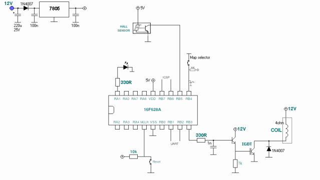

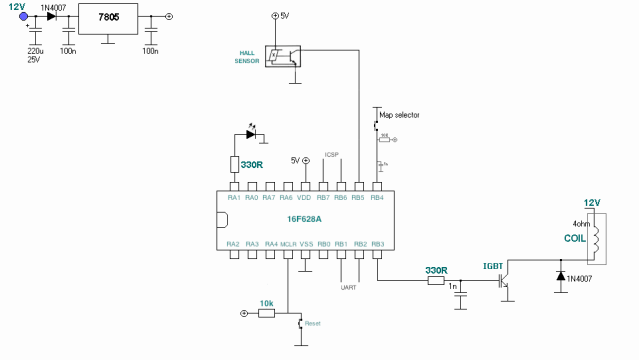

Hi all,
I'm making a programmable ignition module for a very old scooter and have made the below schematic however I've found that with a multimeter in place of the coil the voltage switches correctly and I see 12V however when I put the coil in place the voltage stays at 0V.
The IGBT is this one: HGTP7N60C3D
Any ideas what I'm doing wrong? I'm not very good at the electronics side of things unfortunately.
Thanks for any advice!

It looks as if you do not have enough drive voltage, at least 6V, better 8V, 10V good.

Really? The datasheet says under "On Characteristics" that the gate-emitter threshold voltage is typ. 5V
Am I looking at the wrong thing?

You are looking at the right thing, the threshold voltage is where the device just starts to conduct. There will be enough current to drive a voltmeter but not to do any useful work. The data sheet shows a graph giving the gate votage necessary for the required output current.

You want a voltage follower or common collector circuit. Right now when the transistor is off the gate will be held high. http://en.wikipedia.org/wiki/Common_collector
Notice how Vout is on the emitter side with the resistor connected between Vout and Gnd
I don't think you will need the cap from base to ground, it will just delay the turn off time of the BJT.

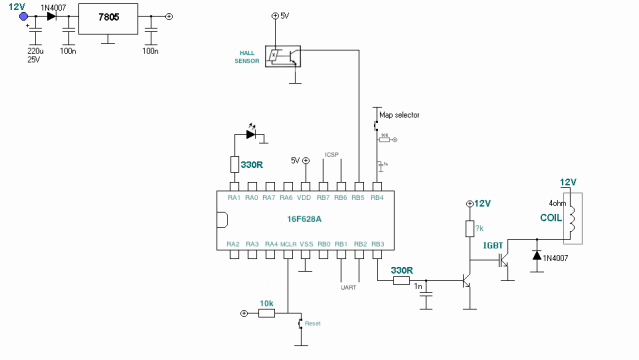

Ahhh, OK. I get it now.
I've integrated that into my schematic, and will test it out now.
Thanks so much for the help!

OK, I've implemented the above schematic and it's not quite working.
With just the multimeter for load everything reads correctly. However once I include the coil the voltage drop across the coil is only 0.45 volts.
Any ideas?

I'm guessing I've done it wrong as I'm not getting any 5V?
This is the schematic.
attachment.php
Thanks for your help!
