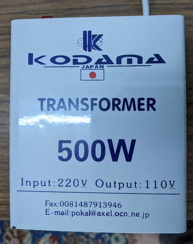

I have a step-down transformer (240v to 110v)
The label says 220V to 110V, so at 240V it will likely produce 120V out.

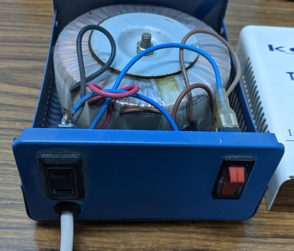

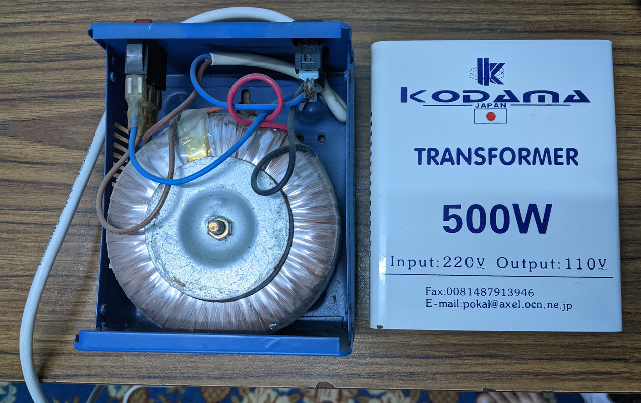

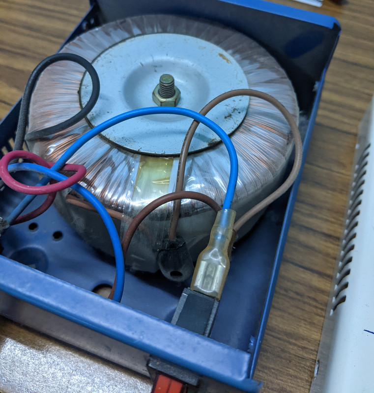

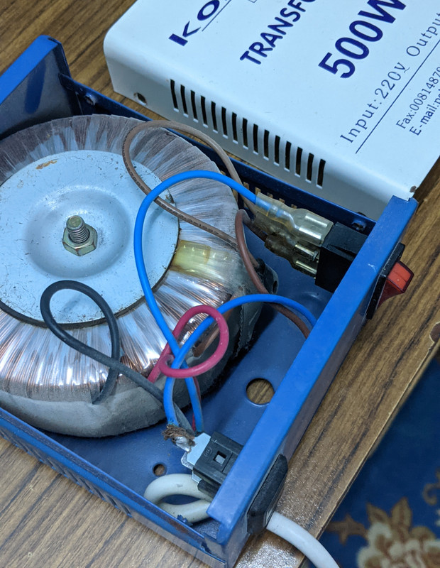

I opened it, but it does not have any board. just the coils and a black small component, which I guess is a small capacitor (second image). here are a few images of what is inside.

Well if you are thinking of modifying it that is the best kind to do it with.
Toroidal. !
You just need to remove the outer insulation wrap and wind on what you need, find out the turns/volt like I said, they are much less on a toroidal, about 2 - 3 t/v Use the same gauge as the existing secondary.

Yeah I am glad it turned out like this. just one thing, one of the lines from the input cable is connected directly to the output? the blue one? is that neutral? shouldn't the primary and secondary circuits be disconnected in a transformer?

How many conductors enter the transformer? If only three, then it could be a auto-transformer.
Or does it have four all together?
If four, measure the resistance between all and see if they are isolated from one another..
Yes, since isolation is not needed for this purpose, it could likely be an autotransformer since they are smaller and cheaper to build.
But you can still easily add windings to put in series with the output to increase the voltage.
