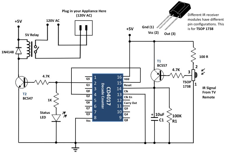

Basically I want to make a simple LED lamp which would take about 9V. For it I want to create an Infrared switch so that I can switch the lamp on with any remote(my TV remote mainly!). I have got an Infrared receiver
( TSOP1738 )
I also have a 4017 counter, bc547 and bc557 NPN transistors and also common resistors and capacitors.
Currently I am eyeing this circuit
but this is used to switch on AC Appliances.
Can you give a modification for the circuit to switch on/off the led lamp? Or any other circuit for this? Please help.
