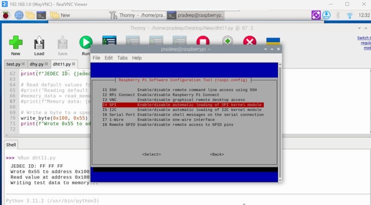

1.Enable SPI Interface:

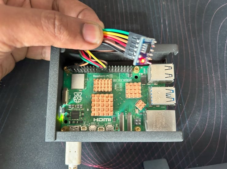

2. Connect the W25Q32: Connect the W25Q32 to the Raspberry Pi’s SPI pins. Refer to the Raspberry Pi 5 pinout diagram and the W25Q32 datasheet for the correct pin assignments.

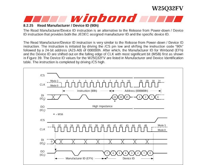

Reading Device ID:
All the Winbond devices have a dedicated manufacturer ID inside the chip. First, we need to test our connection. Let’s read the Device ID and we can verify the connection.
We need to send the 90h and get EFh from the device.

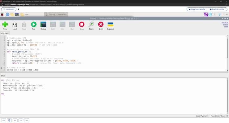

Code 1: Python Code for reading device ID:
import spidev
# Initialize SPI
spi = spidev.SpiDev()
spi.open(0, 0) # Open SPI bus 0, device (CS) 0
spi.max_speed_hz = 100000 # Set SPI speed
# Function to read JEDEC ID
def read_jedec_id():
# JEDEC ID command (0x9F)
jedec_id_cmd = [0x9F]
# Send command and read 3 bytes of response
response = spi.xfer2(jedec_id_cmd + [0x00, 0x00, 0x00])
return response[1:] # Ignore the first byte (command echo)
# Example usage
jedec_id = read_jedec_id()
manufacturer_id = jedec_id[0]
memory_type = jedec_id[1]
capacity = jedec_id[2]
print(f"JEDEC ID: {jedec_id}")
print(f"Manufacturer ID: {manufacturer_id:02X} (Decimal: {manufacturer_id})")
print(f"Memory Type: {memory_type:02X} (Decimal: {memory_type})")
print(f"Capacity: {capacity:02X} (Decimal: {capacity})")\
Code Response:
Here is the output of reading the JEDEC ID from the W28Q32.
Explanation
1.SPI Initialization:
2.Reading JEDEC ID:
3.Example Usage:

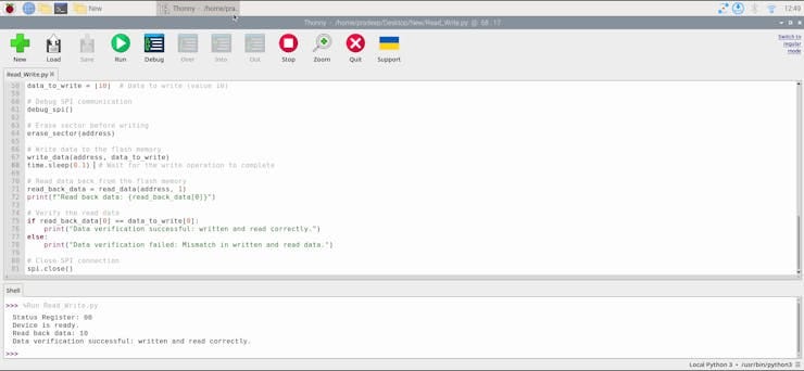

Code 2: Python code for write and read values:

Code Response:
Here is the output of reading the read and write from the W28Q32.
Explanation
2.Write Enable:
3.Writing Data:
4.Reading Data:
- Open the terminal on your Raspberry Pi.
- Run sudo raspi-config.
- Navigate to Interfacing Options > SPI and enable it.
- Reboot the Raspberry Pi.
- MOSI (Master Out Slave In): Transmits data from the Raspberry Pi to the W25Q32.
- MISO (Master In Slave Out): Receives data from the W25Q32 to the Raspberry Pi.
- SCK (Serial Clock): Provides the clock signal for synchronization.
- CS (Chip Select): Selects the W25Q32 on the SPI bus.
- GND (Ground): Provides the common ground connection.
- VCC (Power): Supplies power to the W25Q32 (typically 3.3V).

Reading Device ID:
import spidev
# Initialize SPI
# Example usage
Code Response:
Explanation
- The spidev library is used to initialize the SPI interface.
- The spi.open(0, 0) function opens the SPI bus 0 and device 0 (CS0).
- The spi.max_speed_hz sets the SPI clock speed.
2.Reading JEDEC ID:
- The read_jedec_id function sends the JEDEC ID command (0x9F) to the memory IC.
- It reads back three bytes of response, which include the Manufacturer ID, Memory Type, and Capacity.
- The response is returned, excluding the first byte (command echo).
3.Example Usage:
- The script prints the JEDEC ID, Manufacturer ID, Memory Type, and Capacity in both hexadecimal and decimal formats.
import spidev
import time
# Initialize SPI
spi.max_speed_hz = 8000000 # Set SPI speed to 500kHz
spi.mode = 0b00 # SPI mode 0
# Define some commands for the W25Q32
WRITE_ENABLE = 0x06
WRITE_DISABLE = 0x04
READ_DATA = 0x03
WRITE_DATA = 0x02
READ_STATUS_REG1 = 0x05
SECTOR_ERASE = 0x20
DUMMY_BYTE = 0xA5
def write_enable():
spi.xfer2([WRITE_ENABLE])
def write_disable():
spi.xfer2([WRITE_DISABLE])
def read_status():
status = spi.xfer2([READ_STATUS_REG1, DUMMY_BYTE])
return status[1]
def erase_sector(address):
write_enable()
addr_bytes = [(address >> 16) & 0xFF, (address >> 8) & 0xFF, address & 0xFF]
spi.xfer2([SECTOR_ERASE] + addr_bytes)
write_disable()
time.sleep(0.5) # Wait for the erase operation to complete
def write_data(address, data):
write_enable()
spi.xfer2([WRITE_DATA] + addr_bytes + data)
write_disable()
def read_data(address, length):
result = spi.xfer2([READ_DATA] + addr_bytes + [DUMMY_BYTE] * length)
return result[4:] # Skip the first 4 bytes (command and address)
# Debugging function to check SPI communication
def debug_spi():
status = read_status()
print(f"Status Register: {status:02X}")
if status & 0x01:
print("Device is busy.")
else:
print("Device is ready.")
# Example usage
address = 0x00000C # Address 12
data_to_write = [100] # Data to write (value 10)
# Debug SPI communication
debug_spi()
# Erase sector before writing
# Write data to the flash memory
write_data(address, data_to_write)
time.sleep(0.1) # Wait for the write operation to complete
# Read data back from the flash memory
read_back_data = read_data(address, 1)
print(f"Read back data: {read_back_data[0]}")
# Verify the read data
if read_back_data[0] == data_to_write[0]:
print("Data verification successful: written and read correctly.")
else:
print("Data verification failed: Mismatch in written and read data.")
# Close SPI connection
spi.close()
Code Response:
Explanation
