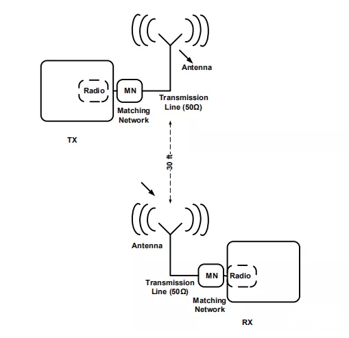

In order to ensure the transmission efficiency of the antenna, the length of the antenna is about 1/4 of the wavelength of the electromagnetic wave, so the lower the signal frequency, the longer the wavelength, the longer the length of the antenna; the higher the signal frequency, the shorter the wavelength, the shorter the length of the antenna. The commonly used 2.4GHz frequency band has high frequency, short wavelength, and short antenna length. Internal antennas can be used, or external antennas can be used. Antennas made shorter, such as 1/8 wavelength or 1/16 wavelength, can also be used, but the efficiency will be reduced. Some devices will adopt the method of "short antenna + LNA", which can also achieve the receiving effect of long antenna. However, in order to achieve the transmission effect of a long antenna with a short antenna, it is necessary to increase the transmission power, so the walkie-talkie needs to transmit signals, which are all long external antennas, while the FM radio only receives and does not transmit, and has a built-in receiving antenna. For example, 2G (900MHz), 4G (700-2600MHz), WIFI and Bluetooth (2.4GHz), GPS (1.5GHz), these common IoT communication methods can be used as built-in antennas.

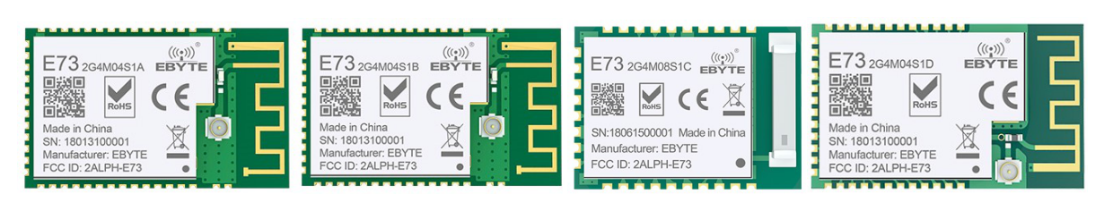

What is the difference between E73-2G4M04S1A, E73-2G4M04S1B, E73-2G4M08S1C, E73-2G4M04S1D? First of all, the four models use different chip solutions, the size and power of E73-2G4M04S1A, E73-2G4M04S1B and E73-2G4M04S1D are the same, E73-2G4M08S1C is slightly different; but under the same test conditions, but in terms of transmission distance, E73-2G4M08S1C has slightly better transmission distance than E73-2G4M04S1A, E73-2G4M04S1B and E73-2G4M04S1D. The power will also be slightly more.
In particular, the transmission power of E73-2G4M08S1C is 8dBm, which is higher than that of other Bluetooth modules, so the transmission distance is slightly longer than that of other Bluetooth products.
If you use the IPEX antenna interface to connect to the external antenna, the transmission distance will definitely be longer than that of the onboard antenna. Considering the requirements of volume and installation, and the transmission distance is also within the acceptable range, the on-board PCB antenna or ceramic antenna is more preferred. But determining a wireless transceiver is not only the parameter of transmission distance, but also the performance of the product and different applications in different usage environments. Therefore, whether it is for the E73 series or other Bluetooth, ZigBee, and GPRS products of Chengdu Ebyte, there is a necessary environment for use, and different 2.4GHz antennas can be selected according to the needs of their own projects.
