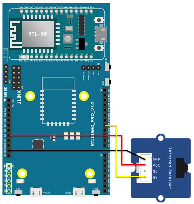

Example: IR receiver
For implementation, Ameba uses a GPIO Interrupt pin and hardware Timer 4.
Open the example in "File" -> "Examples" -> "AmebaIRSendRecv" -> "recv"
In this example, we use Grove Infrared Receiver, other infra-red receiver works similarly. In general, we will use 3 pins: VCC(connects to 3.3V), GND, RX. In the example, we connect RX to D3 (which has GPIO Interrupt function).
Wiring diagram:
RTL8710 Wiring diagram:
Compile the code and upload to Ameba, then press reset.
If you have NEC remote control in hand, you can test that whether the Ameba IR receiver works. Or you can follow next example to use another Ameba board to make an IR emitter yourself. Note that the received messages of the IR receiver will be shown on the serial monitor.

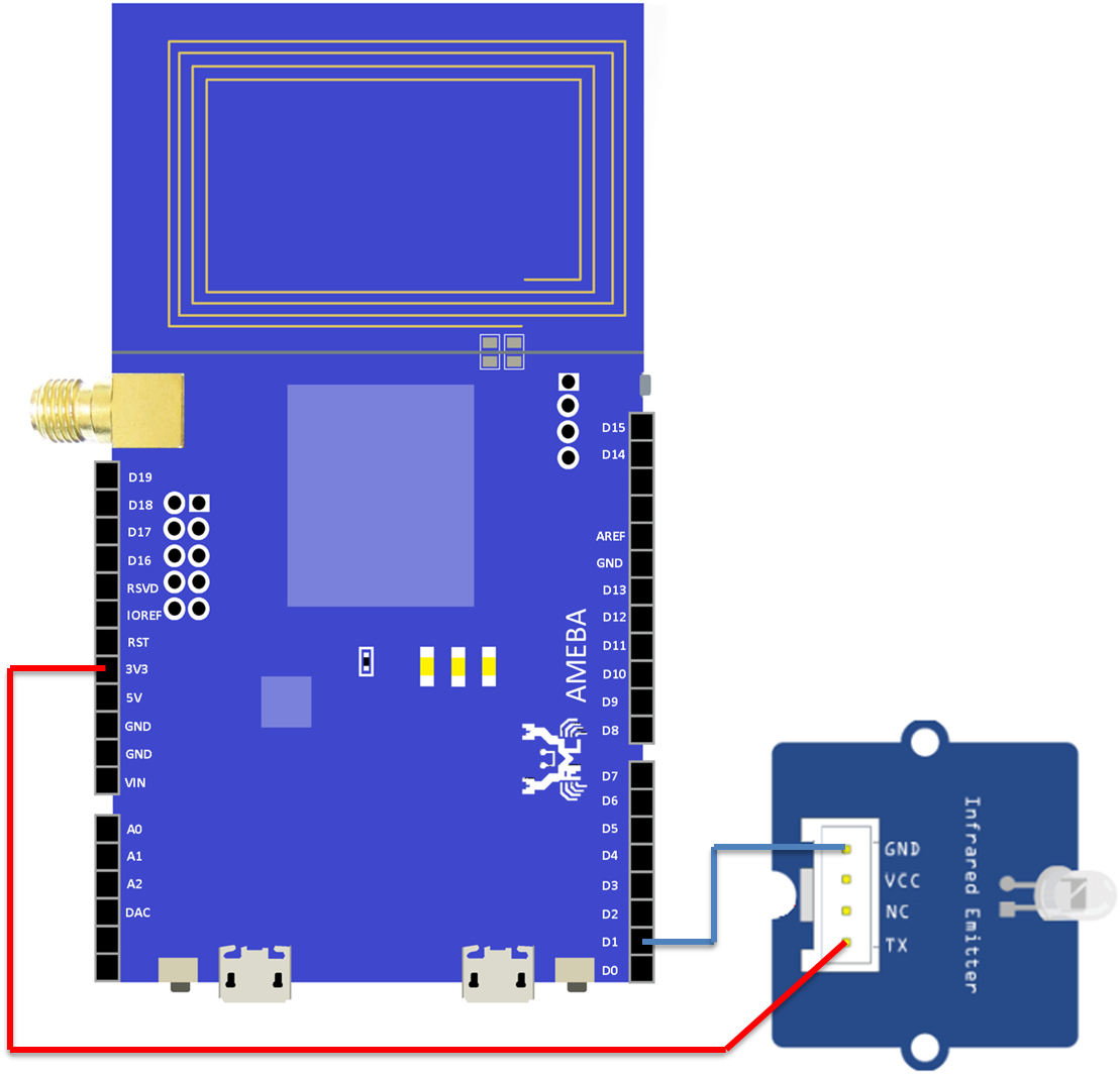

Example: IR emitter
A typical IR emitter has 2 pins. However, the Grove Infrared Emitter has 3 pins: VCC, GND and TX. In practice, we can only use GND and TX.
To transmit 38KHz signal in real time, Ameba uses TX of UART to emit the signal. Hence, when we are using Ameba to emit IR signal, D0 pin (UART RX) would be unavailable.
Following is the wiring diagram:

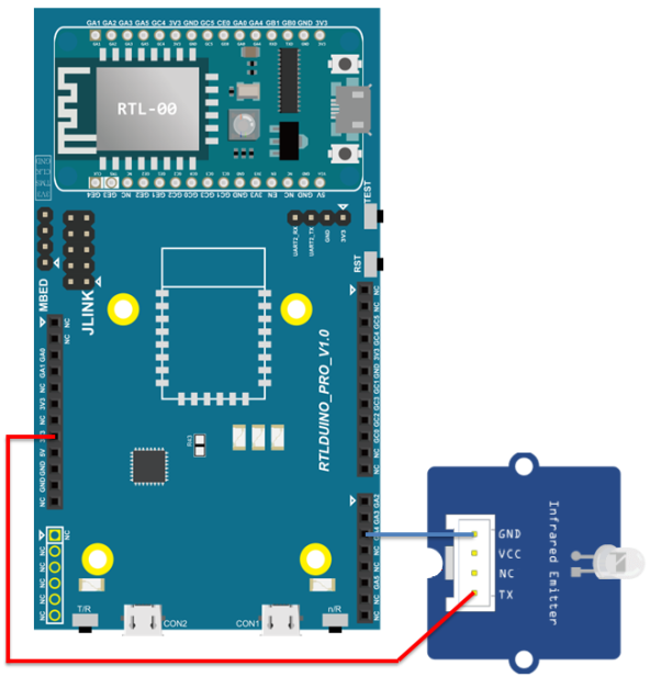

However, since the TX of UART is usually on 3.3V, this leads to unnecessary power consumption. Therefore, we rearrange the wires to connect Ameba UART TX to the GND pin of Grove Infrared Emitter, and connect the signal wire of emitter to 3.3V:
RTL8710 Wiring Diagram:
In this case, when the emitter is not emitting signal, GND and TX are both at 3.3V, voltage difference is 0.

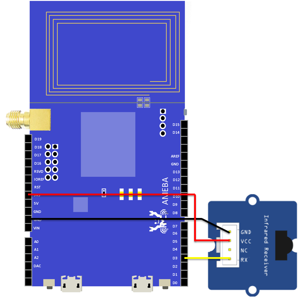

Wiring diagram:

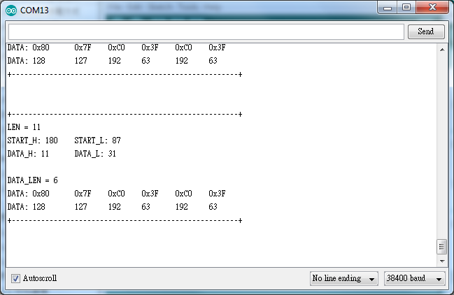

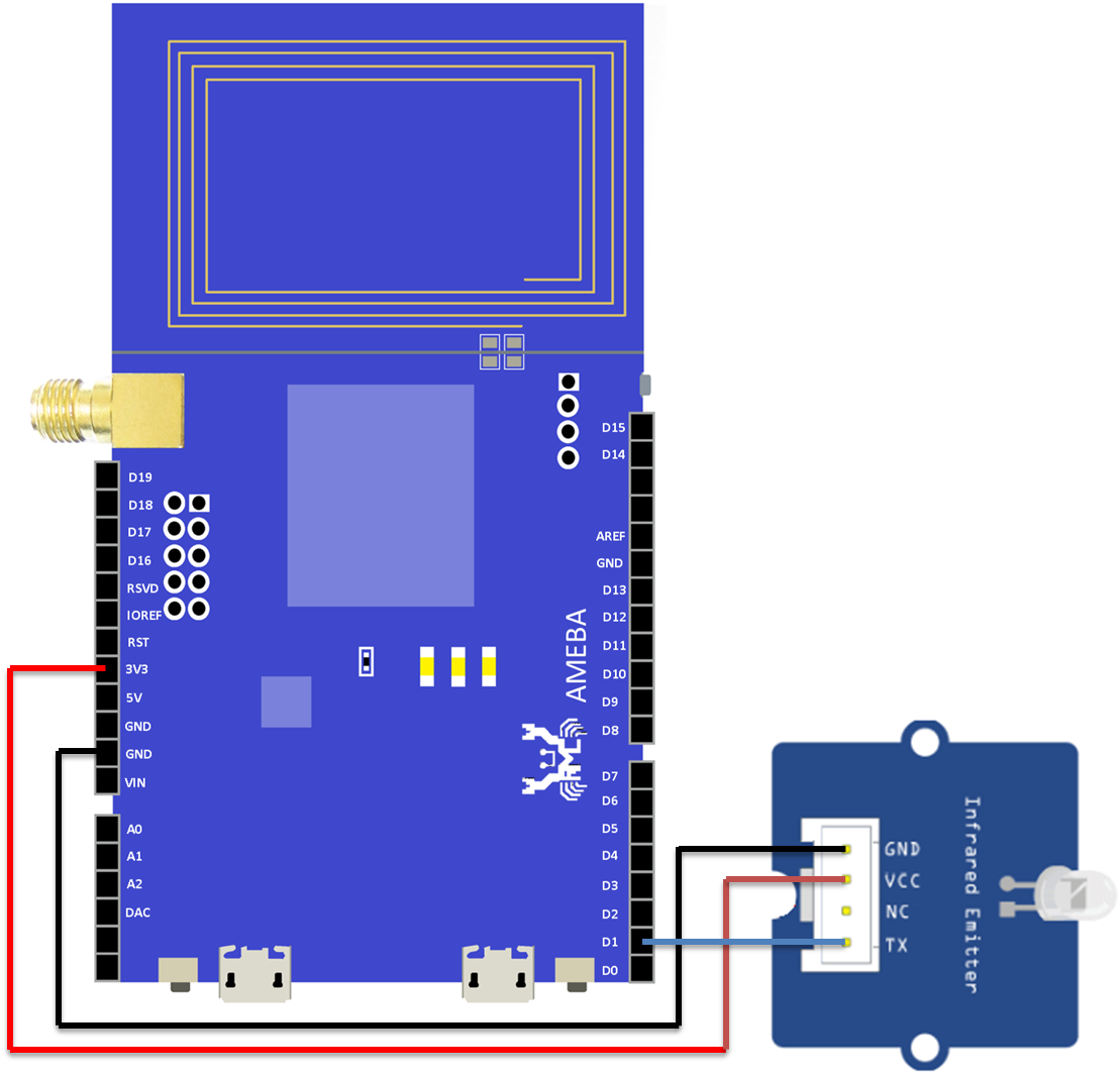

Example: IR emitter
