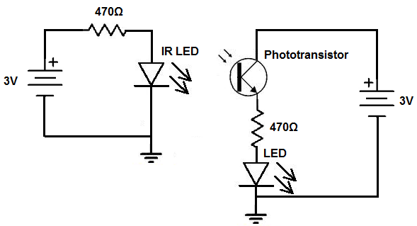

Would these do the trick?
https://www.amazon.com/gp/product/B00EFOQEUM/ref=ask_ql_qh_dp_hza
Connected to something like this?
https://www.ebay.com/p/Tolako-5v-Re...-1-Channel/1963275315?iid=253993010146&chn=ps
Would a simple circuit be enough? I would a switch to the transitter circuit to turn it on. Also add a relay to the receiver circuit.

No, those are 38KHz receivers that require a lot of active electronics to use, typically a microcontroller.
Stop looking for IR transmitters and receivers and look for what I suggested:
IR LED and
Phototransistor
Bob

Could you be specific? Everytime I look up what you suggest I get items similar to what I linked.
Are you suggesting something like a BPX38 or BPW76A/B?
And SFH 4855?
