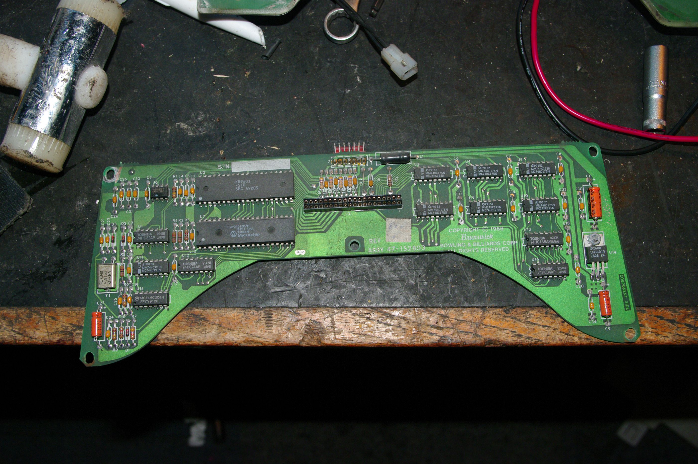

Hi! New guy here, going here because, well, it is electronics, and no matter where you use electronics, the same principles are at work.
So, I got a keyboard matrix... well, I don't have it myself, and I can probably never get hold of one myself, so I can't use a sniffer/analyzer to find what I need.
But I mostly all components in images and name except some smaller capacitors.
It is a keyboard matrix with 24 buttons, a keyboard matrix to parallel controller, D Flip-Flops, an UART and a RS485 chip to get the TTL over to RS485 specs.
If I gave you guys all my images, the names of the MCs, even the datasheets, is there any way you (we?) could find out what the serial outgoing com looks like, or at least narrow it down to the point I can use some hours, instead of months, in HyperTerminal with a USB-RS485?
If you deem this project at all possible, I will post all the images and other info I got on this.
Cheers for any input!
Jim, Norway

Well, since there's a UART there, that would be a great place to start :)

Forgot to actually finish. I know my software, but I am unsure on electronics.
The Keyboard matrix controller is a KR9601, the UART is a AY310150, and the 485/422 is SN 75179BP.
Due to time restraint I can't get you the crystal, voltage regulator and flip flops and other stuff right now (images), so hold on if you need that as well :)

Here is a link to the album with the images from the original PCB: http://imgur.com/a/g4AlH
The pictures are taken with a DSLR and are rather large, so I don't wanna piss someone with a 64k connection off or something! :p
EDIT: Well, here is one picture just so you see without clicking the link. For the skeptical, never heard anything bad about imgur!
They are all easily readable on your photo
As Steve said, you know what the UART is so google that part number and see if you can get a datasheet for it
then you may be able to do some tracing to the I/O connection in the upper centre :)

You need to find out if NB1, NB2, NP, TSB and EPS of the UART are connected to Gnd or 5V This will give you the number of data bits, parity, stop bits.

The Vcc going into the KR9601 seems to be going to the mentioned NBs, NP, TSB and EPS on the UART.

That corresponds to 8 data, 2 stop, no parity. You will have to trace the clock circuitry to find speed or measure the frequency of the clock pin.

Would it be wrong to assume that the recieving end would have the same speed? Because that i can probably find with analyzing Equipment, either analyzer software or osciloscope.
Can i find what the data bits will look like from this then? I know what each key will give from the keyboard encoder, not sure how the flip flops are connected in all this, but for my use it is probably not important anyways.
Pretty much necessary. The 2 stop bits will cover a small discrepancy. The bit rate is 1/16 clock.
