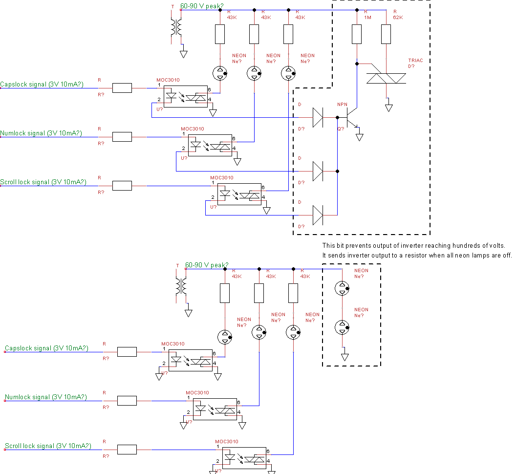

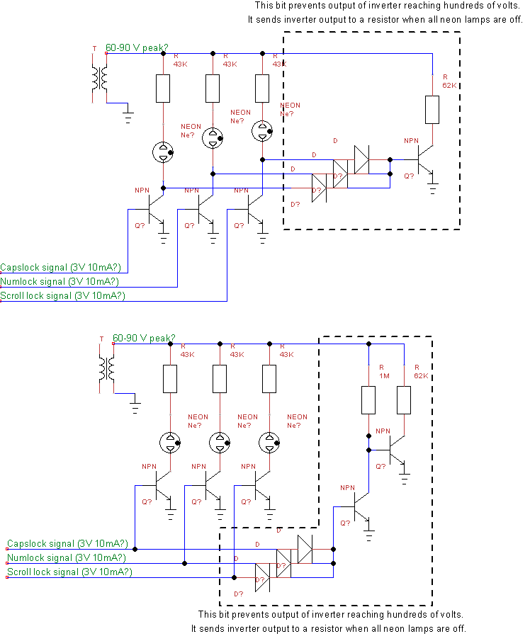

Thanks for everyone's responses. The keyboard is not valuable so I don't mind risking its destruction for my project. I want to drill holes in the keyboard for the lamps to protrude out of the case.
I have designed this circuit which reroutes the output of the inverter to a resistor when the lamps are not lit to prevent the inverter producing a very high voltage when the lamps are not lit. I actually have two circuit designs but I don't know whether one is better than the other, other than the first using fewer components.
What kind of transistor should I use? The CE voltage will be high but the current will be very low (less than 3 mA for the transistor attached to the 62K resistor).

Ummm. All your switching is set up for DC, but the transformer/inverter output is AC :confused:.
If a transistor collector junction breaks down under high voltage stress, the keyboard electronics (and possibly the PC to which the keyboard is attached) is at severe risk of being fried. Consider using opto-isolators.
