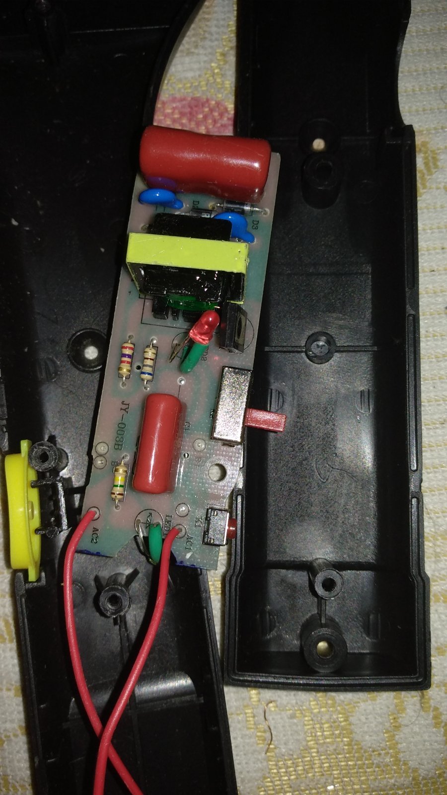

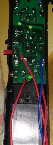

Here are two photos of front and back of the PCB:
Back: Red and Blue wires are from battery, other two red wires under from the plug.
Front: The large capacitor at the top is 2000V, the smaller one is 400V
After using and turning off, if I were to touch it while removing the covers, I'm getting a shock. I think I managed to discharge the capacitor with the shock, so now I'm using a line tester to discharge the capacitor when I open it, one end of the capacitor gives off a spark when I touch it with a line tester.
I'm using 1 square millimeter normal electricity copper wire to make a coil, one end is soldered near left end of the capacitor, the other end is a spark gap at the other end of the capacitor but it is unable to create EMP to effect any digital device, at the most it can cause a line which lasts for fraction of a second on the screen of a mobile phone.

So your zapper is fed with AC voltage which probably gets rectified to drive an oscillator. The oscillation gets stepped up by the transformer then rectified and stored on the 2000V cap. If there is a bleed resistor across that cap, it's not evident from the pic. Methinks the cap would hold a possibly lethal charge for a considerable time.
Thanks for your valuable analysis. If a bleed resistor is something which is attached to the bottom of the capacitor, then there is no bleed resistor. If not, I'll have to take a photo from the other angle.
What could I be doing wrong, have I not wound the coil tight enough or the wire has higher Ohms, the most it could do when I turn it on is cause thin lines on the mobile phone's screen for a fraction of a second. I used an enamel wire after this, and it couldn't cause any EMP effect too. Will this be enough to affect for up to 2.5 inches? If I need to increase the power, do I need to add higher capacitor or build my PCB circuit?
