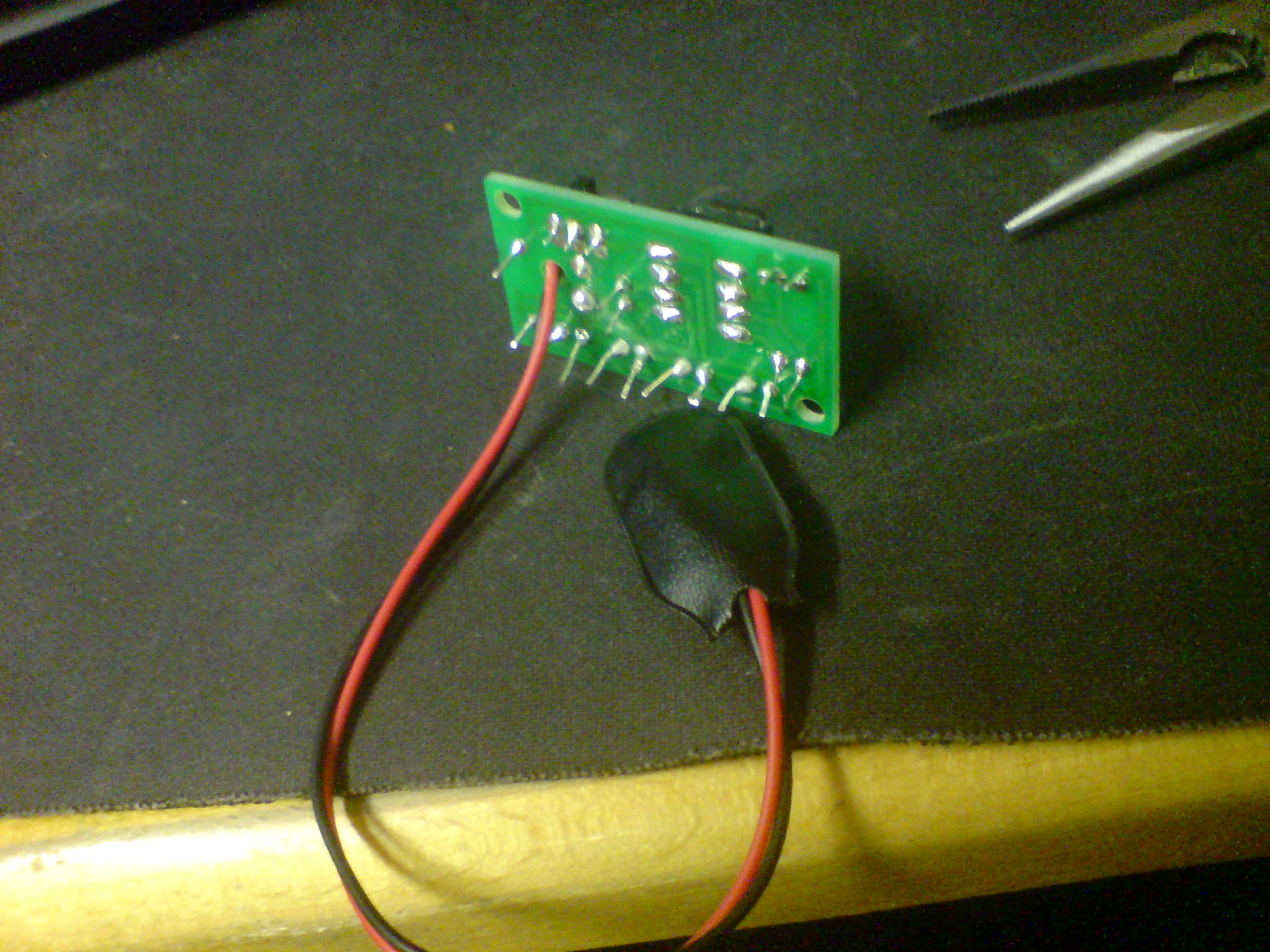

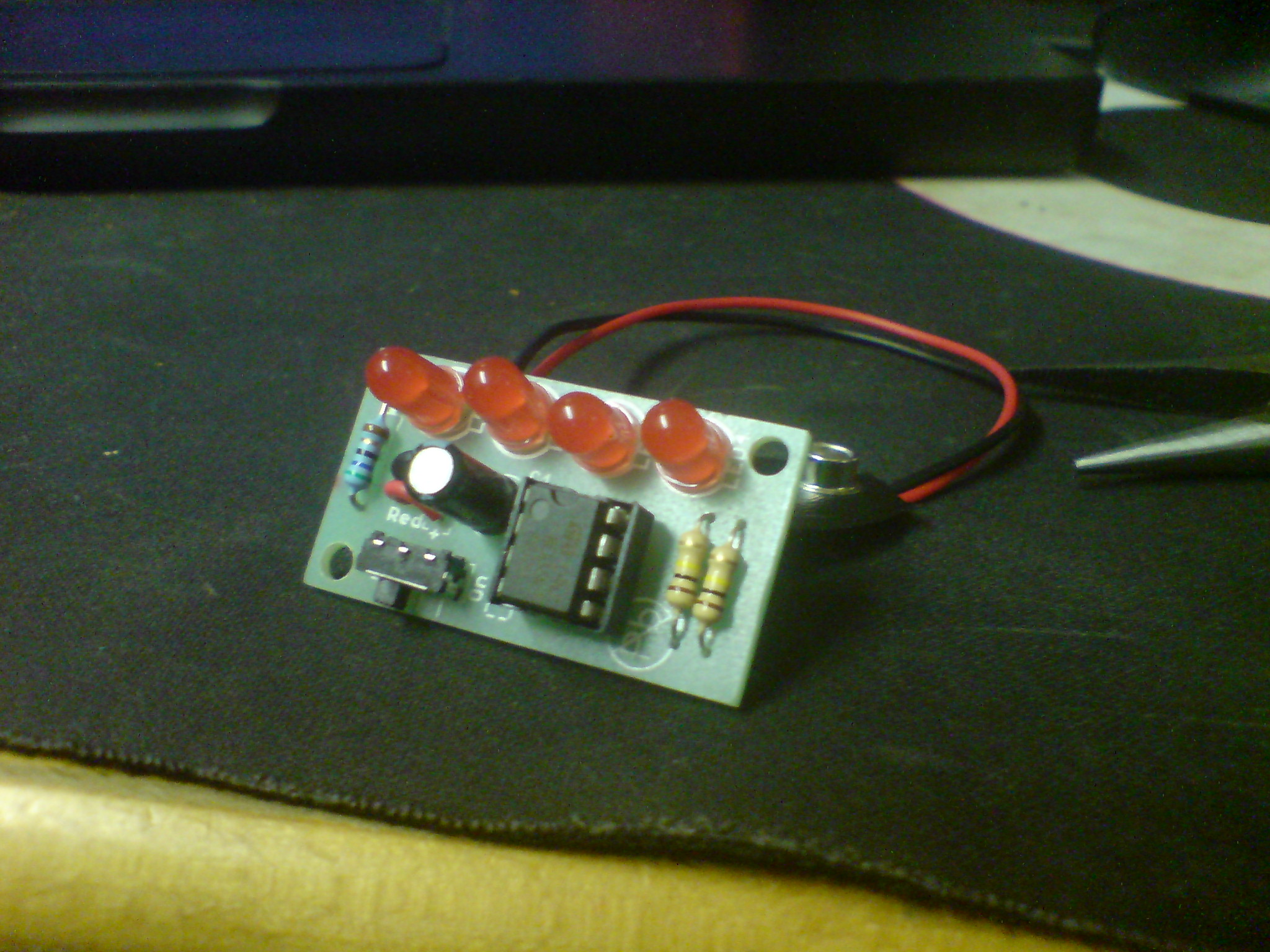

Hi all, nice to meet you.
I recently found an interest in electronics so I bought a basic project kit from Maplin. Nothing fancy, just 4 LED's that flash. I thought I'd share the finished article with you, not bad first solders eh? Although I couldn't clip the component legs as much as I would have liked. Any tips for how to get in between the gaps?
I've got an electronic dice to do next, watch this space!

You'll need a dedicated electronics wire cutter - other than the needle-nose pliers you got there.

The kit title is 'LED Battery Saving Lamp'. I got it for about £3.99 I think. It was brighter than I expected. I'll have a look for some proper wire cutters :)
If I understand your question correctly, its flashed in a 555 configuration. Is that what you meant? I've been meaning to draw out the circuit so i can properly understand what's going on. I don't (yet) know any more than it has to be a full circuit to work :p I know the purpose of resistors but that's about it.

Yes, good LED's can be surprisingly bright.
Ok, I see. They are all series-connected and then the 555 makes them blink briefly (like a bike rear lamp).

So there you go - you (hopefully) now understand your first circuit - sorry it took so many words to describe :rolleyes: and apologies to all those that understand circuits far better than me, and can spot a million flaws in my description. There are many variations and elaborations on this most basic astable, and you may well have a few other components though looking at your picture again, I think I only see one extra resistor, which is probably just to control the current flowing through the LEDs (here's a link to a good resource for calculating the value of resistor to get an LED to light correctly even when it is connected to the wrong voltage http://www.theledlight.com/ledcircuits.html
