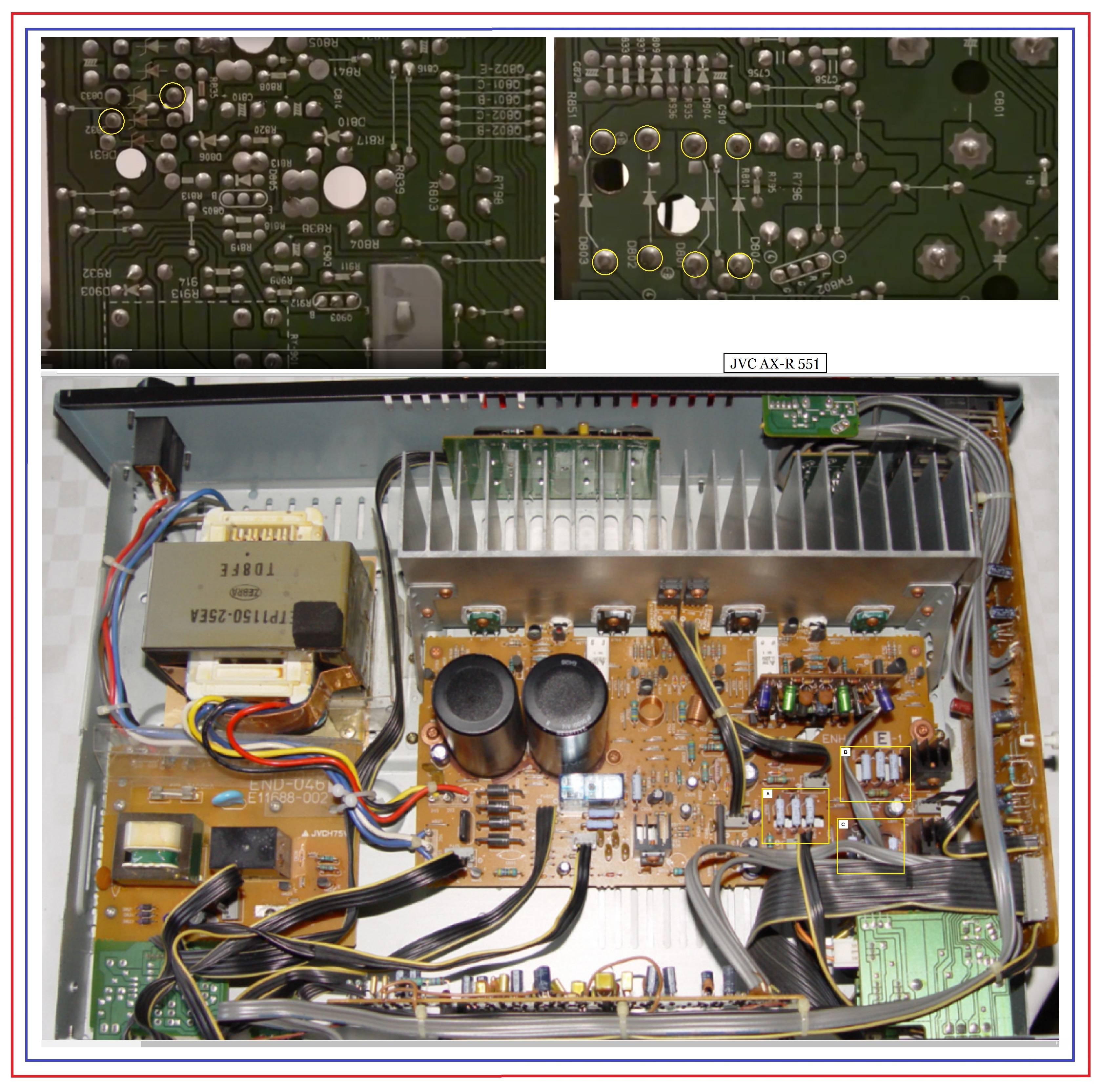

If that unit has been well "cooked" thru the years of use, check out these particular areas of power devices.
They are being pointed out with YELLOW MARKINGS . . .particularly . . .C . . .area.
If any crystallized joints . . . .optimum procedure would be to pull components scrape leads and retin leads.
For its companion foil land , use solder wick to absorb and get free of old solder, retin and then install parts leads and use fresh solder for the joints.
Illustration:
