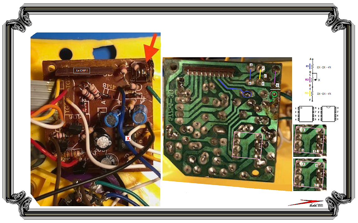

Hello, I’m seeking advice from anyone with experience repairing electronic toys. I have a toy saxophone that uses four AA batteries, has a three-position slider switch, a volume knob (potentiometer, I assume), circuit board, and speaker. There are also several buttons (saxophone keys) that trigger different sounds. There appears to be continuity throughout the battery compartment. The volume knob showed a change in resistance value when I measured it with a meter. The switch I’m not sure about. I’m not versed in using a meter much beyond checking for continuity. I’m hoping someone will offer a concise procedure for tracking down the faulty part in this circuit.

The problem is that there is no audio output. There is no master on/off switch. The three-position switch selects between different output configurations (normal, loop, etc). When you press one of the seven buttons, a preset pattern of notes plays. But no sound is coming out.

Following 73’s advice as well as I could, here are some measurements I took (with batteries in, circuit energized):
  • Battery compartment shows continuity and 6V.
  • Placing meter leads on each of the solder pads on the speaker shows continuity and 8 ohms.
  • The three-position switch was showing continuity on pins 2 and 3 (viewed left to right) in all three positions. I desoldered and resoldered and now it shows cont in these positions: Auto Stop: red and orange; No Loop: orange and yellow; Continuous Loop yellow and open pin 4.
  • Finally, when set to Max, the volume knob showed continuity on blue and green and showed 11.2K ohms on brown and green. At the Min setting it showed continuity on brown and green and 11.2K ohms on blue and green.
Any advice for further testing components or tracking down the reason for no sound would be greatly appreciated!

Thank you, Bertus and Bluejets! I think you’re exactly right. I’ll post more pics from other angles to confirm.
Assuming it is a trimpot, do you think the brown goop is sealing wax to keep it in position? (This was mentioned in the Wiki link)
I’d be interested to hear advice for next steps in trouble-shooting.

Sir Bricago. . . . . . . . . . . . .( I'se done never mets myselfs a Bricago, before )('less'n that's Brian from Chicago )
[ Key up the eeeeeeeeeeerie organ music, and let the SEANCE continue ]
While I now "read the board" . . . . .
Keep up with my thought flow in the . . .
PHOTO REFERENCES . . . . . below
Your COMPLEX mean music machine function is being accomplished all within the "Le Chip ! " that is black epoxy ? mounted and covered up on the front side of that phenolic blank.
Its pin # 8 output is the music audio that connects at the BLUE oval , to the BLUE wire that is at the top end of the volume control.
In accordance to how loud you want to play, the movable pot wiper at the GREEN wire, feeds back to the board at my GREEN circle and routes down to an audio input pin of the audio amp chip. That nearest blue E-cap . . .possibly ? . . . . looks like it might be an in line coupler.
NOW . . . . .your task . . .Captain Kirk . . . . .should accept it . . . . . .is to surreptitiously get the identity of that RED X chip back to us ,as well as to use your ultra sub mini Minox spy camera and use the diagrams to ascertain which is being its pin #1. ( I put both possibilities down. )
Where I have the "Dig Here" RED X should be the 8 pin power audio amp for the speaker audio feed.
Worry . . .worry . . .WORRY . . . .all of it, being about that cheeeeep phenolic trim pot.
My . . . . VERY HIGHLY Edd-u-cated guestimation is that is being used in the final operational testing of the unit. You DON'T want to be sending out a mistuned SAX-a-ma-phone . . .DO YOU !
Look at the schematic redraw of that extreme corner circuitry. Its components are being color coded / for association.
Hypothetically . . .I'm randomly assigning 100k for that total resistive trios values.
Should I use the extreme 47 K values the 5 K should fall in the CENTER of that 100K value and then one should be able to s..l..o..w..l..y VERNIER adjust within its limited adjustment range.
AND that will be a very VERNIER adjustment . . . . . not a ZIP - - - - - - -ZIP . . . .BAMMMM, like the touchy adjustment wiper of using a sole 100K pot would be.
Then, I also gave two other resistor sets values to let you see that that "sweet spot" adjustment / resistive point can be skewed around, up and down the 100K spread resistive spectrum / sector, just by those R1 and R3 resistor values, inter ratios being chosen..
Sooooooooooo what is happening here, is that there is being a master oscillator within the chip and that frequency gets divided down in digital stages to get all of the musical scale frequencies. With all of them being spot on, by virtue of the digital division resolving capability.
And then . . . . .AND THEN . . . . .AND THEN ***** . . . . . the production line test person uses that trim pot to set that master oscillator frequency SPOT ON and then applies a dab of a fractable sealant to its rotor, to dry.
THE SPEAKER . . . . .
Looks like it uses two YELLOW wires going to the PCB and logically, end up at the RED X IC.
Can you now confirm if there is either of them making direct wired connection into an IC pin, or is a series E-cap in circuit ? . . . .but I don't see any on that immediate side of the board.
Gimme some feedback . . . . . . or more ?'s

I made a little progress today. Hopes were high, then quickly dashed. Here’s what happened: I was starting to hunt for the info that Edd requested. I thought I’d try spraying the back off the circuit board with Deoxit just to see if contact cleaner would spark it to life, and….IT DID! It would play for a few seconds, then stop. I noticed that jiggling the speaker wires and/or the capacitor(?) stamped “104” near them seemed to affect the sound’s cutting in and out. Things spiraled downward from there. Here’s the sequence of events:
  1. Thinking it could be a speaker wire connection problem, I de-soldered and re-soldered them to the board.
  2. I also de- and re-soldered the black and white wires on the ground pad, near the speaker wire connections. (There appeared to be three holes for the ground pad. One was empty when I removed the solder from the original connection.)
  3. I removed the capacitor(?) and tested it with my meter. It read 122 nF. It’s stamped 104. I don’t know what this means. I re-soldered it (blue circles and arrows)
  4. In the process of doing 1-3, and at separate times, I wound up accidentally detaching all three wires connecting to the volume potentiometer (brown, green, and blue). From here on, I didn’t get any more sound output. I resoldered the wires, and I noticed that no continuity showed between any two combinations of these wires. I don’t know if they would have shown continuity before, when it was working intermittently.
Edd, I know I drifted off course after an unexpected ray of hope, but I will endeavor to get you the info you requested.
I’ve attached another photo of the “mystery component” from before, which appears to be a trim pot stamped 200K.
I’ve also attached pics of the three-position switch which is very sticky, despite lots of Deoxit. I think it will need to be replaced. If you can offer specs to search for, I’d appreciate it.
Thanks for reading and for your help.

It’s FIXED!! Here’s what happened today:
I re-read Edd’s posts to see what info he needed. I did manage to try the (4.7K ohm) resistor test between the + batt terminal and the X and Z terminals on the pot, but the results were negative. I took a picture of the amplifier chip(?) and posted it below.
Today, I had the bright idea of removing all the components from the casing to both prevent damaging the plastic parts and allow easier access to the components. Wish I’d thought of this sooner.
One problem I kept running into was accidentally detaching the wires while moving the whole shebang around. I ended up resoldering (to the board) both speaker wires, the black and white ground wires, the red wire from the battery, the green and brown wires from the pot, all three wires on the pot itself, the three wires on the three-position switch, and both white wires on the “stop” switch. Plus another battery wire or two on the battery assembly.
I replaced two capacitors for no good reason (stamped 104 and 103), but the change that got it working was resoldering the brown wire to the board after it too came loose.
I think the key to this repair was “refreshing” the solder connections for the wires on the circuit board.
So to summarize lessons learned:
1. Remove the wiring harness from the enclosure.
2. Check battery terminals for correct voltage.
3. Deoxit PCB and test for signs of life.
4. Expect brittle wire connections.
5. Reheat solder connections to refresh.

Sir Bricago . . . . .
Congranulations ! . . . .
THANK GOODNESS . . . .
. . . . . that you had no wire come loose and not know . . .FOR CERTAIN . . .where / (to which? SMALL solder blob) that wire was previously connected.
Here is that units AUDIO AMP info, in case it is ever needed in the future.
AND when I look at all of its pins, 7 are being BRIGHT AND SHINY EXCEPT pin 4, its ground pin
Could that pin be BLACK and oxidized . . . . thus the loss of your ground access within the chip ?.
BUT, your "puttering" around and re soldering that pins solder blob, may have broken thru the oxide and touched into the clean conductive metal of the pin ?
TDA2822M . . . . . DA DA Sheet . . . . .
https://www.st.com/resource/en/datasheet/cd00000134.pdf
BTW
. . . . poor choice of probability of failure of those two disc ceramic capacitors . . .
they should still be perfectly functional, till long after the future upcoming return of the dinosaurs.
