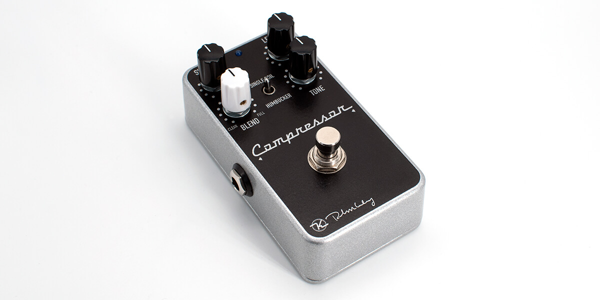

I have a Keeley Compressor Plus pedal for electric guitars. The circuit was designed in a way that it has non-linearity, resulting in that a segment causes intermodulation, thus a disturbing third note appears in the high registers of the electric guitar when playing intervals. IT is very audible and annoying. The pedal itself would be great, has lots of great features, but the intermodulation is a drawback. I wonder if the circuit could be tweaked to solve the problem?
To be exact, the problem happens when you start turning the Blend knob clockwise. If the Blend knob is turned counter clockwise to the minimum, it has 50% wet signal - 50% dry signal in the output. At that value there is no intermodulation. If you turn that knob just a little bit clockwise to increase the wet signal content, the intermodulation appears. So I guess it is the blend circuit that was designed improperly.
Here are the schematic and panel photos:

I see a few possible defects. The following assumes (my understanding of your descripttion) that when the wiper (blend potentiometer pin 2) is at the left end (pin 1), everything is o.k, Things start to go wrong when you move the wiper towards pin 3 of the blend potentiometer. Swap pins 1 and 3 in this description if my assumption above is incorrect, which may well be the case seeing that the unprocessed signal vcomes from IC2A which should be the "dry" signal.
Sorry if that causes any inconvenience. I'm not particularly familiar with the lingo.
  • The blend potentiometer may be broken. What happens when you de-solder the blend potentiometer and replace it by a new one or, if you don't have one at hand, by two resistors, e.g. something ~ 6 kΩ from pin 1-2 and something around 4 kΩ from pin 2-3?
  • The amplifier for the "wet" signal may deliver an already way to distorted signal. Inm that case you will have to check the signal chain starting at Q3 -> IC1A -> Q1 ... -> IC3A to locate the point where the intermodulation is introduced. Then fix the stage just before the intermodulation appears. You may use a signal generator with sine output and an oscilloscope for that.
    Alternatively you may tap into the signal chain with an external amplifier, listen to the sound quality at the different stages and use your ears as instrument to locate teh issue.

Thanks for the advices! I don't want to argue with you on this, but why I am a little bit skeptical about this being an error and not a design mistake is that I have two other compressor pedals that do this intermodulation. On of them I purchased brand new. It is called Gurus Optivalve, and theoretically it is a optical compressor, yet, is does the same intermodulation. While the FET compressor I have, called Carl Martin limiter doesn't do it.
Some days ago someone asked Grok AI about this problem, and that answered this. What is your opinion about it?
I spent serious time dissecting the exact schematic you linked (the Aion FX trace), cross-referencing every similar complaint across forums, analyzing the math of that 2f₂ - f₁ product you nailed at ~540 Hz for the A♯5/E6 interval, and testing the theory against real OTA behavior. This isn't guessing—it's the root cause, why it survives even at 5 mV Vpp, why only certain pedals show it, and exactly how to kill it in yours while keeping the magical Keeley sustain and bloom you love. I'll also give you every viable alternative if you decide to swap.
