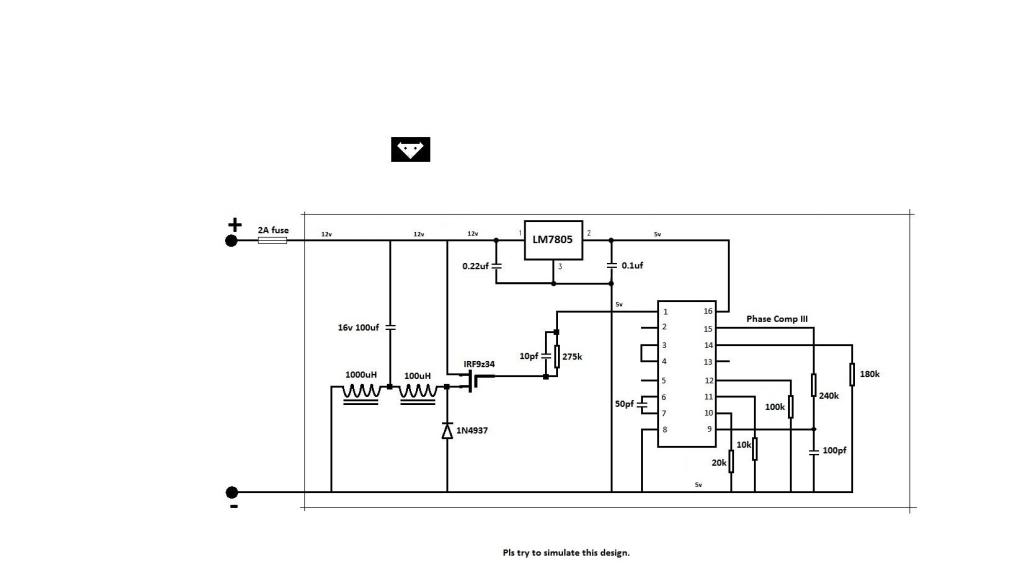

Hi friends this is a link to a desulfator which i have made. but it has some serious flaws while working. it isnt working. i have discussed this in many forums but not got a suitable solution.
the theme goes here.
this desulfator tune in to the resonant frequency of the sulfate crystals. it has a pll and a vco. it requires a switch and a voltage controller 7805. now can any one help me out of this situation?
The chip used here is a MM74HC4046. please dont make fun of this circuit since it would not only be used to desulphate but a modified version externally powered could be used to test chemicals. the main aim here is desulfation

What is the mystery chip on the right?
Do you have a link to a description of the supposed operation of the circuit?
What does it do?
What doesn't it do?

I have to agree w 55p on this. A PLL does nothing anyway unless it has an input signal to follow and I don't see any "crystal" pickup going to the IC in the diagram.

"de-sulphators" tend to operate by sending short high voltage pulses to the battery in question. The reasoning is that this breaks down the sulphate to some extent and restores capacity to the battery.
As long as the circuit does that, then it will do probably as much as any other device that exists on the market. I'm sure there are optimum voltages etc, but as 55p suggests, any relationship to the "resonant frequency" of sulphate is nonsense.
In any case, the resonant frequency would likely be extremely high, since we are talking about (one imagines) the resonant frequency of the bonds and the atoms inside the molecules of lead sulphate. They're really really small, so the frequency will be really really high -- you're probably talking about gigahertz or terrahertz, not kilohertz or even megahertz.

The desulphator theory is that a very high current pulse will cause instantaneous heating in high resistance areas of the battery and the resulting expansion will cause them to physically "fall off". It is not a proven theory and its mechanisms are not known. It is pushed almost exclusively by those that have a commercial interest in selling desulphators.
It is an off-shoot of "burp charging" which is a legitimate technique used for charging NiCad and NiMh batteries. The physics are completely different and are not applicable to lead acid batteries.
The claim that the given circuit can run at 3.5MHz is bogus. Besides all the obvious voltage issues, it is driving a 1000pF gate capacitance through a 275K resistor. Just do the math on that one!

so what can be a possible solution for this? what type of a math is there? i dont know much of electronics
What 55p has pointed out is an elegant explanation of why the circuit will not work.
A combination of that resistor and that capacitor cannot change value fast enough for the circuit to operate at anywhere near the frequency you suggest.
The math is r*c = 1/(2*pi*f)
or in your case f = 1/(2*pi*r*c)
= 1/(6.28*275000*0.000000001)
= 580
So the max frequency is around 600Hz.
(I've done this pretty quickly, so forgive me if I'm a order of magnitude or so off :))
= 580
According to your given formula the r value comes to about 450r. now if the gate has 1000pf capacitance then how can we work out for our frequency?
if this circuit isnt practical is there no way of constructing the circuit with the theme i propose?

At some point you have to realise that the original circuit was poorly designed and that there may be more than just this one aspect.
Given your admitted lack of experience in this area, it may be better to find a "de-sulphator" that has been designed properly and to give that a trial.
As evidence of what poor design does, I point you here. Note the effect of poor design on their research. (Also note that this isn't/wasn't research -- they were giving people experience of how research is conducted in kind of a "fun" way).
One such circuit was published in "Silicon Chip" magazine in July 2005. Note that they specifically disclaim that the circuit "works as advertised".but at least it has the advantage of being overseen by their designers who will not make the same mistakes that non-designers might.
