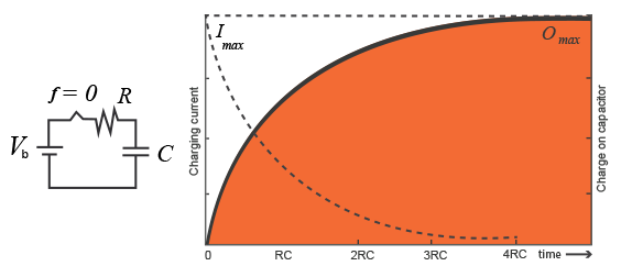

I could I check capacitor with 1000uF and 16 volts ? May I put in series 2Kohms resistor then charged with 9 volts battery up to %63.2 will be 7.5 volts. How many seconds it should take a charge if is capacitor good ? Thank in advance for your answer !

What you are describing is Tau, symbol τ, is the greek letter used in electrical and electronic calculations to represent the time constant of a circuit as a function of time.
That is a times constant for an RC circuit.

Effective Series Resistance (ESR)is the real resistive component of the complex impedance Z(Ω) = R + j X(Ω) of the device. Your capacitor!

All capacitors have ESR, but the higher capacitance (and therefore lower reactance) of electrolytic capacitors makes ESR more significant and (ESR) Effective Series Resistance is a good electrolyte health indicator. ;)
