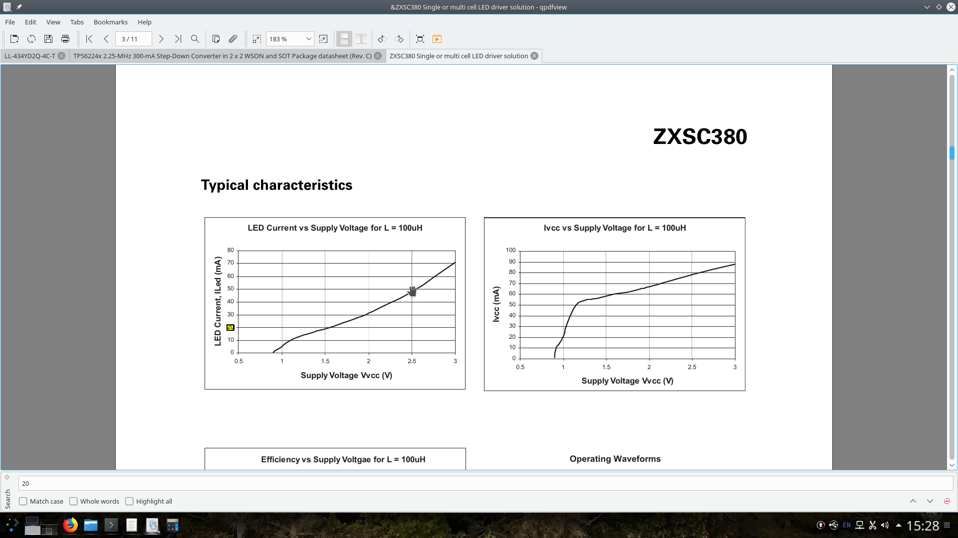

I have never used led drivers and after some good hours of searching I am still at loss. In the specific case of the ZXSC380FHTA led driver, will the current be constant at the output and if it will be, to what value ?
It says that
"the IC generates constant current pulses that are ideal for driving single or multiple LEDs over a wide range of operating voltages"

The datasheet says for 18mA to use a 100μH inductor.
By changing inductor value, the current increases or decreases.

To me that isn't really a "constant" current source, since the current varies with supply voltage. It's not a regulated current source in other words. It's sort of like a fancy, efficient resistor.
Its purpose in life is to boost the supply voltage and allow LEDs to be driven from a single 1.5V cell, and it also controls (limits) the current, but you'll still find the LED will get dimmer as the battery voltage drops. Depending on your application this may not matter. I think this IC is commonly used in LED flashlights.
To set the amount of current, you'd have to select an inductor value corresponding to the supply voltage. For example, for V = 1.5V, and L = 100uH, you'd get 18mA to the LED. But as the battery drains to 1.2V, the current would drop to 13mA, so you would get some dimming over the life of the battery.

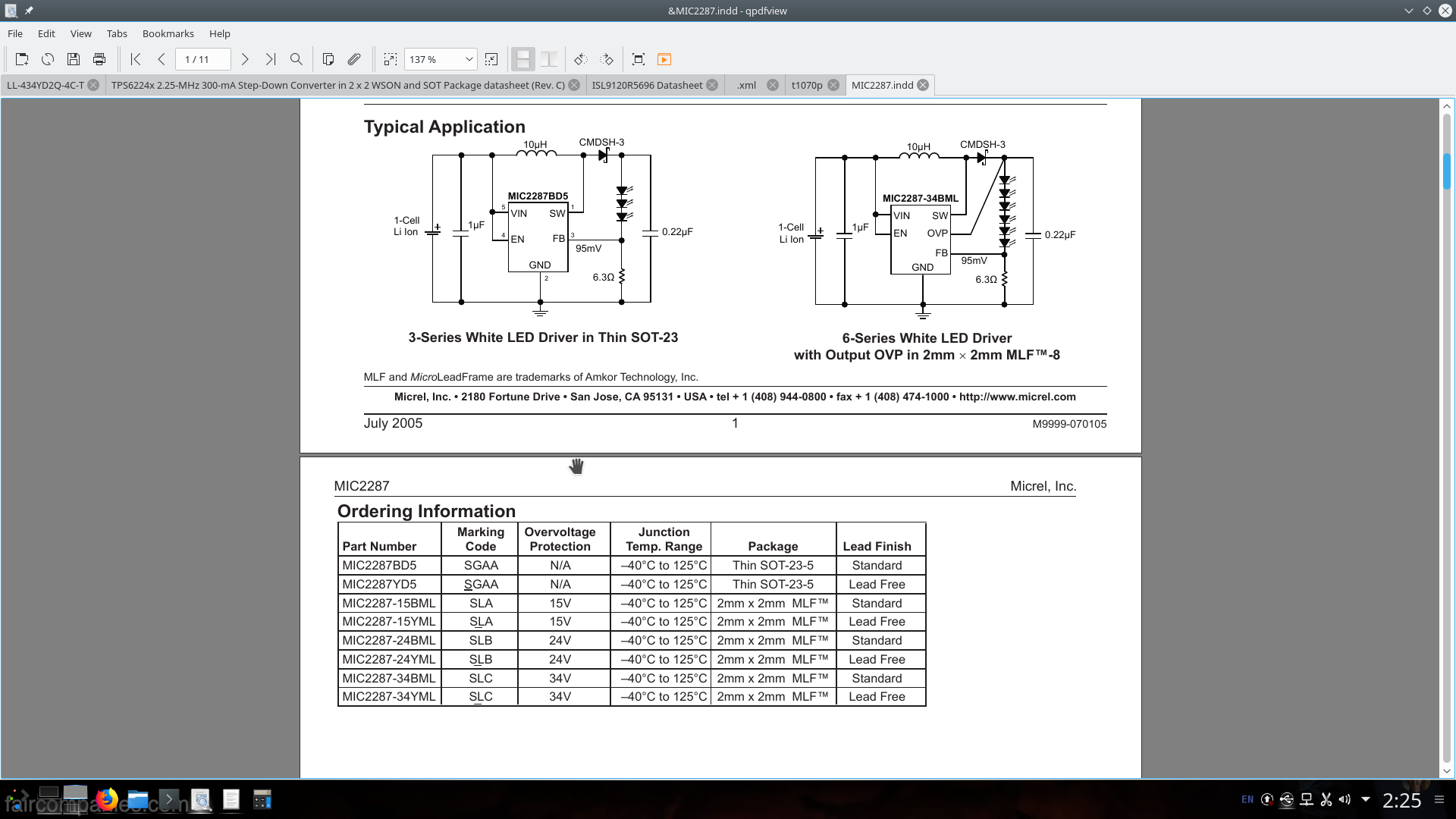

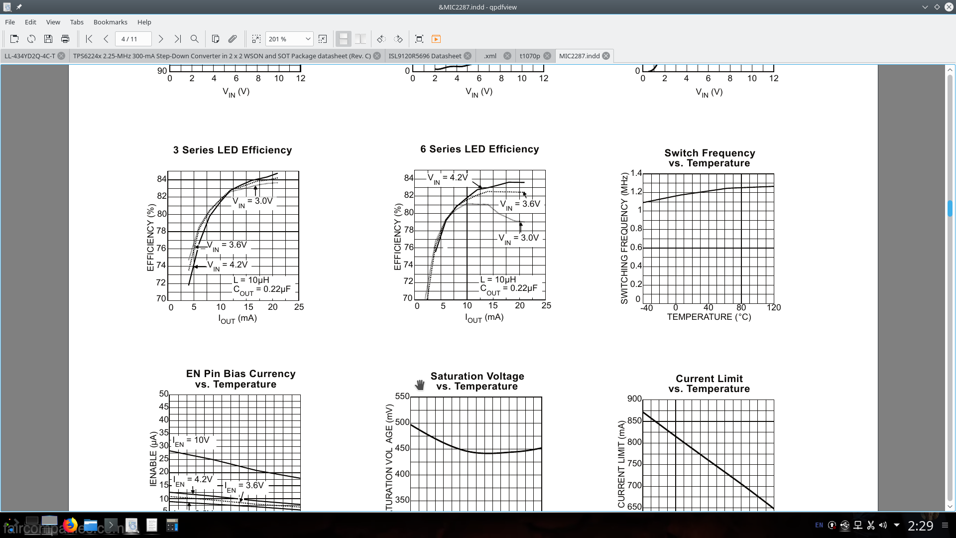

Is there a minimum output voltage for the MIC2287 ? Datasheet only specs a max of 34V.
Also, is an ~84% efficiency decent or kind of low for these chips ?
Looking at the 3 series LEDs @ Vin = 3.0V, 20 mA graph. Judging by the graphs below I am speculating maybe 85% efficiency for just one LED.
Harald Kapp
Nov 17, 2011
14,317
Nov 17, 2011
14,317
Output voltage cannot be lower than input voltage with this boost topology.
Minimum input voltage is 2.5 V so that sets the limit.
In my opinion 84 % is acceptable given the comparatively simple circuit design. More complex designs claim to achieve up to 98 %. Is it worth the effort? It's up to you to decide.
