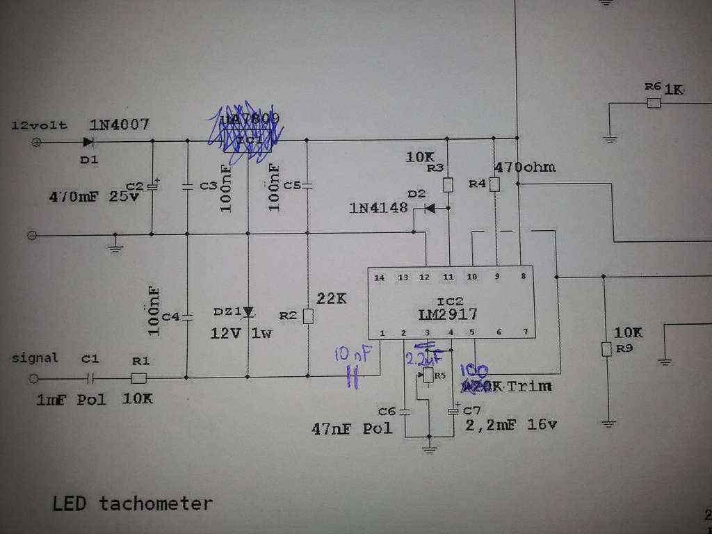

I am trying to make an LED tachometer to use in my car.
I was trying to go by this circuit here:
I built it on a breadboard, and for the life of me I couldn't get it to work. No matter what, I I would only get the first LED to light up, and the second LED would be dimly lit, with no change with the input signal.
The tachometer signal on my car is a +5-volt square wave. Has anybody ever done any sort of similar project, and maybe has a different schematic I can build, or any advice on what might have gone wrong in my circuit?
Also, I can't tell if pins 8 and 9 in the bottom LM3914 are supposed to be connected or not, because the lines cross, but there is no dot. It is inconsistent with the rest of the drawing.

I think the lines should cross but not connect, you can check this by looking at the data sheet.
You should separate the F to V convertor from the display (use a potentiometer as substitute) to get the display working first.
Is the 2917 producing output pulses, should there be a capacitor across C9 to give a smoothed output?

Maybe it’s better if you isolate first if LM2917 have varying dc output w/ corresponding input signal from car signal. This is to simply troubleshooting your circuit.

Pins 8 and 9 on the lm 3914 should not be connected. pin 8 is only for a reference adjust output voltage. pin 8 can be connected through a resistor to give a different output reference voltage. i have built one of these with one lm 3914 and it works perfectly for me. but i used two variable resistors: one to set when the led's come on for a specific rpm for when the engine is at low revs and two: for when the engine is at hight revs. try using a 10nf capacitor going into pin 1 of the lm2917, a 47nf on pin 2 of the lm2917 and a 2.2uf on pin 3 of the lm 2917 these caps have to be spot on to get proper speed of linearity display to appear. if cap values are too high the display will not work or could be too slow when working. i never used a voltage regulator either becuase the lm3914 can withstand up to 35 volts without damage or false output readings, got from the data sheet. and the lm 2917 can withstand up to 28 volts but using one should not effect it. try using a 100k pot for trimming on the lm2917. i also would suggest that you disconnect the F to V converter from the display and just connect that up to the coil of the car to see if u r getting a change in voltage with respect to frequency when revving the engine. and testing the trimmer pot to get a certain voltage to suit a certain rpm for example 2000rpm/volt.

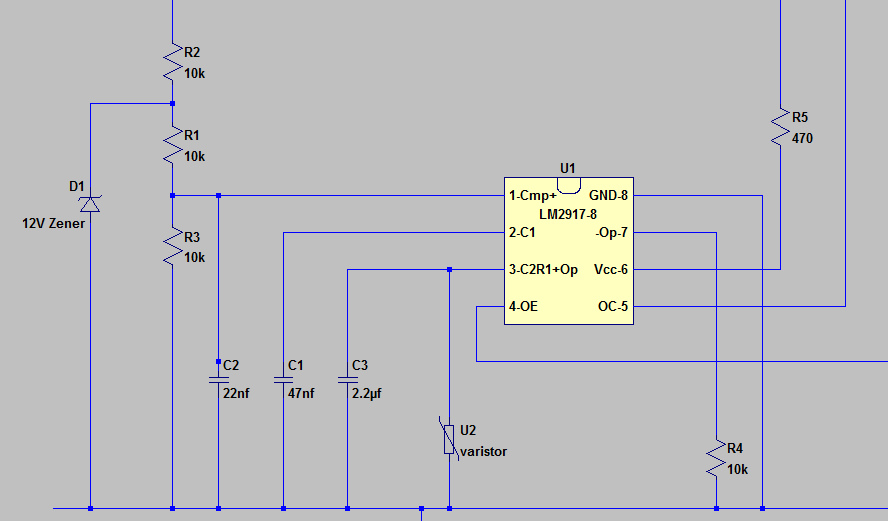

my version of it.
the 8 pin version of the chip would be a lot easier, it also minimizes a lot of wires that would be on the circuit.
use a 12 volt zener diode, forgot to put the value in diagram sorry!! :)

I have drawn up the freq to voltage section using the 8 pin lm2917, i had a look at the datasheet to make sure i had the correct pins
f to v LED Tacho by benji325, on Flickr
How do you attach images without linking to another url?

i put wrong values in the first time here is the proper circuit with component values sorry!!! :)

Thanks Steve, I realised once you posted that I should have searched on the forum/read beginner threads.
Mechtronics, I am relatively new to circuit design (at uni we have only done some circuit analysis but we have not had to choose certain values for components yet) and I would just like to check with you about the caps and zener diode ratings:
Is it ok to use:
-0.022uF 50V Ceramic Capacitor
-0.047uF 50V Ceramic Capacitor
-2.2uF 50V Radial Electrolytic Capacitor
and a 1 watt 12V zener diode?
I am not sure about the use of ceramic vs. electrolytic caps, apparently it depends on the frequency and capacity required by the application.
What would be the best resource for learning about this kind of thing?
Thanks very much for your help

yes those values should be ok to use its the same thing any way just specified in microfarads etc. zener diode should be ok to use too.
