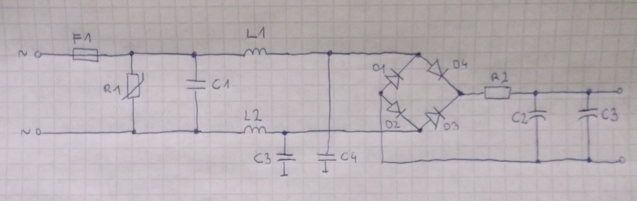

Hi all,
I'm repairing the LED TV damaged after the lightening strike.
I've started with creating simple scheme (see below) and testing the components.
Only the fuse was blown (NSFT 2.5A 250V).
I replaced the fuse with the new one (<PS> E JET bel F2.5A 250V) and plugged the power, but the fuse immediately blew.
I suspect the problem may be with the type of the fuse: F2.5A probably means fast-blow, but I'm not sure whether NSFT is the slow-blow.
I've read that fuses used on the input are mostly the slow-blow, so I probably used the incorrect one, but I would like to be sure to use the slow-blow one.
I've tried to google the phrase "NFST 2.5A 250V", but found nothing helpful.
Does somebody know is "NSFT 2.5A" is rather slow-blow or fast-blow?
Thanks in advance,
Michał

Assuming it's a switching power supply, which it almost certainly is, the usual problem is destruction of the switching device (usually a MOSFET) that drives the primary of the transformer, due to overvoltage from the surge. Other semiconductors on the primary side, and possibly also the secondary side, may have been destroyed as well. The driver IC usually survives.

A fast blowing mains fuse is usually a result of a failed bridge rectifier
I have seen that so many times
after checking the bridge rectifier ( may be 4 separate diodes or a single package)
then move on to Kris's suggestions which would then be the next most likely choices :)

Ah yes, thanks Dave. The bridge rectifier is the best place to start.

I've checked the bridge rectifier and the diodes are working properly.
There was also failed resistor (R2 on the scheme above, 1.2 Ohm ceramic) - I've replaced it with 1.5 Ohm (haven't had 1.2 Ohm, but I guess it shouldn't be a problem).
As I understand you said that the problem was not related with the type of the fuse, am I right?

Probably not. I guess the 1.2 ohm resistor was between the negative side of the bridge rectifier and the source of the MOSFET, right? In that case the MOSFET is almost certainly toast. What's the part number?

The 1.2 Ohm resistor is between the positive side of the bridge rectifier and the transformer.
I found on the PCB that the fuse should be "T2.5AL" so it's definitely the slow blow fuse and I need to buy one.

OK, that still points to the MOSFET.

I've found the MOSFET near the transformer's primary, it's TK5A65D. The measured D-S resistance (in both directions) is ~0.6 Ohms without the gate voltage, according the datasheet it should be 1.2 Ohms with the gate voltage, so it seems to be dead.
I've found also the short-circuit on the diode connected with the source of that transistor.
I've examined (with the 'diode test' function of the multimeter) the bridge rectifier diodes and it shows the volatege ~0.550 V in both directions on every diode, so I guess the diodes should be also replaced.
But as far as I remember they were not damaged when I was testing them on Saturday - maybe soldering slow-blow fuse and plugging the power cable killed them...

Yes, it's possible that replacing the fuse and powering it up with the MOSFET still short circuit could have forced enough current through the bridge rectifier diodes to take them out as well.
Have you identified a suitable replacement for the MOSFET? If you want suggestions, add your location to your profile so we know what suppliers to look at.
