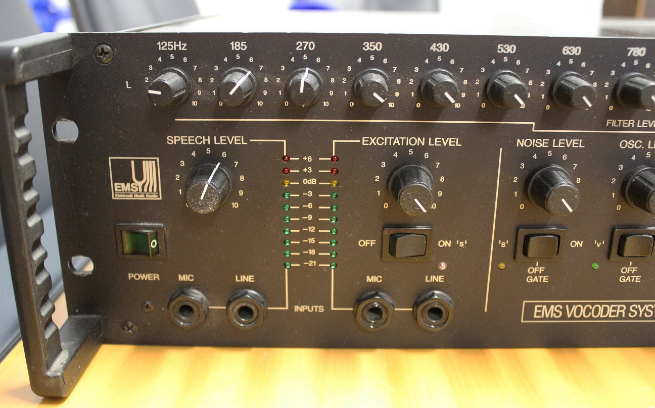

I'm building a vocoder which has two LM-3915 based LED PPM meters in conjunction with its two audio input amps.
The project article gives no explanation of what the 10 LEDs represent so I searched around and came across an article entitled "LED graph circuits" which shows the following scale:
LED 1 = -27 dB
LED 2 = -24 dB
LED 3 = -21 dB
LED 4 = -18 dB
LED 5 = -15 dB
LED 6 = -12 dB
LED 7 = -9 dB
LED 8 = -6 dB
LED 9 = -3 dB
LED 10 = 0 dB
Fine, so now I know how to mark the front panel :)
But comparing it to the EMS Vocoder 3000 I see a slightly different scale:
It appears the readings have been shifted so the lowest level starts at -21 dB while it adds two levels above 0 dB (+3 and +6 dB).
So I'm trying to make sense of this, wondering if the EMS design is a more useful one than the one I'm building or if these are just two different ways of achieving the same thing? Are there standards to what kind of metering scale should be use in (professional) audio applications? How about the LED colour -is there some sort of standard for that as well? The vocoder I'm building says the last 3 LEDs should be red while the one by EMS has just two red LEDs and a yellow one before that.

+3dB sounds only a littler louder, +6dB is again a little louder than +3dB. +6dB is a voltage gain of 2.
Must people think that an amber or yellow light is a warning (here it might warn that distortion is beginning to happen at this level and red might mean that severe distortion is happening.
You need to calibrate the circuit so that the LEDs tell you warnings of the levels.

dB is a logarithmic measure of relative power (or voltage). What marks 0 dB is up to the designer of a system. The relevance is in the differences in dB as Audioguru explained.Typically a system designer could set 0 dB as the reference level where no distortion exists. Or to a lower signal level in order to gain some headroom for overdriving without distortion.
Another use is with defined reference levels, e.g. 1 mV equiv. 0 dBmV (note the suffix mV). Here the system designer is free in his choice of reference level only within the confines of the definition (dBmV, dBµV etc.). This notation is used to make signal levels comparable between systems.
See for example this Wikipedia article (sub-section 'suffixes and reference values') to learn more.

I'm not sure if I understand correctly, but are the meter readings not necessarily defined by an already set reference?
In other words, the LED input meters in the vocoder I'm building might not have any specific dB meaning (i.e. the lower led means -27dB), but rather just shows that one or two lit LEDs means "just a low level input", some more LEDs obviously means "higher level audio input" while having the last couple of red LEDs lit means "warning! danger of overload"?
So, in order to make the LEDs actually mean something I need to calibrate the system?
From the LM-3915 (dot/bar LED display driver IC) datasheet I believe it's already calibrated to give some actual meaning, but perhaps it's the input to the LED meter circuitry which needs to be calibrated?
I assume the actual calibration involves feeding a stable audio source (i.e. a signal generator with a sine wave or whatever at a known voltage (using a digital multimeter to simultaneously read the voltage), then in part of the LED display circuit insert a trimpot so as to make say the lower LED light up only when the input voltage is at whichever standard you choose that -27dB should mean?
Many words for something that can likely be explained a lot simpler, but did I understand the basic concept?
Harald Kapp
Nov 17, 2011
14,317
Nov 17, 2011
14,317
I think you got it. If you want to calibrate a system, you need to consider the whole signal chain, including any amplifiers, attenuators, filters etc.
The nice thng about using decibels is that it makesrelative measurements easy (add/subtract a few dB). If you want to convert relative dB values into absolute values, you need a defined reference for 0 dB.
What are you going to use for 0 dB reference?
Why do you want to calibrate the system at all? The designers of this vocoder will (or at least should have) designed the VU meter such that for any level at or below 0 B (according to their display) the signal is undistorted. That's the important part.
What do you gain by knowing that this 0 dB level is equivalent to say 1 V or any other voltage?

My main reason for asking is because I want to know how to label the front panel next to the LEDs, like done with the EMS vocoder in the photo I posted earlier. Apart from looking good I also want it all to make sense of course ;)
I took a closer look at the project instructions and it says (for the LED meter schematic I posted in the beginning):
"IC1 is a full wave rectifier with a peak detector charging C2 to the peak voltage of the input signal. IC2 is a logarithmic display driver, the sensitivity of which is determined by R7, 8. The LEDs are at 3dB spacing. The red LEDs illumintae when the filters overload. The LEDs have their own power supply."
So I assume that since R7 and R8 are fixed resistors, the LED meter display board has already been pre-calibrated with those specific resistor values to match the rest of the vocoder's circuitry.
TTL
Oct 24, 2013
195
Oct 24, 2013
195
So at least I likely don't need to look into calibrating the meters to match the rest of the circuitry.
I assume the next thing I have to do (when the vocoder is completed and working) is to measure the audio input voltage of the input amplifiers, compare that with which LED lights up and use that as a base for what the actual dB values are (perhaps matching the numbers in my first posting).
