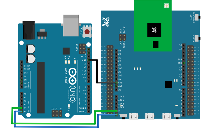

Here we are going to use Ameba as an I2C master and Arduino UNO as a slave to achieve I2C send and recv.
Before connection, make sure to upload the “Examples -> Wire -> Slave_receiver” example code to Arduino UNO.
Connection is shown as follows, here we are using PA_26 as SDA pin and PA_25 as SCL.

Then copy and paste the following code line by line into REPL to see their effects.
from machine import Pin, I2C
i2c = I2C(scl = "PA_25", sda = "PA_26", freq=100000) # configure I2C with pins and freq. of 100KHz
i2c.scan()
i2c.writeto(8, 123) # send 1 byte to slave with address 8
i2c.readfrom(8, 6) # receive 6 bytes from slave
