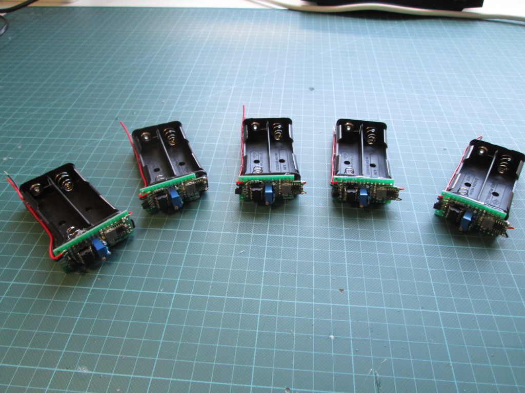

Hey all,
In my long quest to automate as much of my home as possible I want to have battery powered modules, mostly for sensors.
To achieve this, I made a comparator circuit connected to a transistor, which allows me to cut the power on my circuit when the batteries reaches 3v.
The circuit:
Note the voltage divider, it divide the battery voltage by a factor of 10, in order to make sure the battery voltage is always below 2.3v (Because the comparator is powered by 3.3v, and cannot take a higher voltage on it's pin than on it's power supply)​

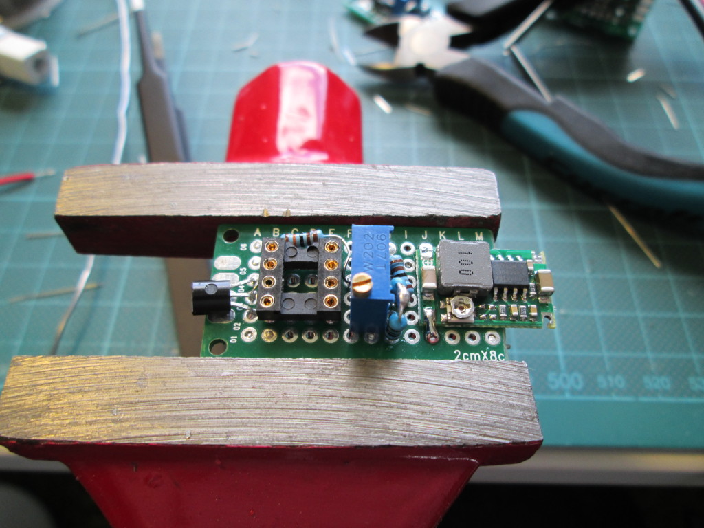

Module prototype:
the transistor base resistor is 1.2k on this picture (seen above the comparator socket), I had to change it to 220ohm in order to have enough current flowing through my circuit. (thanks Arouse1973 for helping me find out the issue)​

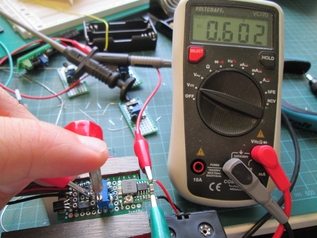

setting up the threshold voltage
The modules ready for the batteries
I didn't work much with comparators before, so I learned a lot this weekend, it was very interesting! I hope this could help some of you :)

The resistance from Vbat to GND by the resistive divider is a bit on the low side. It will drain the battery even with the olad turned off. You should increase this divider's resistance considerably.

These values my be too high a you'l have to account for the input current of teh comparator.
I suggest not more than 1.8M/200k, probably 900k/100k.
Also note that ypur circuit is prone to oscillations when the battery voltage comes in the treshold range:
When the power is turned off due to low-batt indication, current flow from the battery stops and the battery will recover a few mV, thus turning power on again. Add some hysteresis to the comparator to form a Schmitt Trigger circuit and prevent oscillations.

Is that a 2K pot? That will also drain the batteries even when the load is switched off. You need to consider a much higher resistance pot, as suggested by Harald for the voltage divider.
