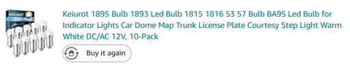

I'm changing to LED's from the incandescent. I did not initially find LED's that lined up with the base, desired color and power supply. Since that time, I found these. Thanks guys!
