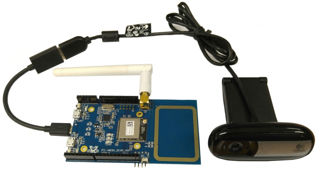

There are 3 micro usb host on Ameba, the one at the back supports OTG UVC, by which the USB camera can transmit video data to Ameba, and Ameba converts the video to rtsp streaming and sends it to the network.
We use Logitech C170 webcam in this example, please find its detailed spec in the link below:
http://www.logitech.com/en-in/product/webcam-c170
The default video streaming format of Ameba is Motion JPEG 320 x 240, users can adjust the parameters according to the need.
Detailed wiring is as below. Connect Micro USB OTG to Ameba, then connect the USB camera.
Note that in the above wiring diagram, the webcam uses Ameba as power source. If the power supply of Ameba is not sufficient, this would cause the camera unable to work. That is, you have to make sure the power source provides sufficient power to Ameba, or you have to choose the USB OTG which can be connected to external power source.

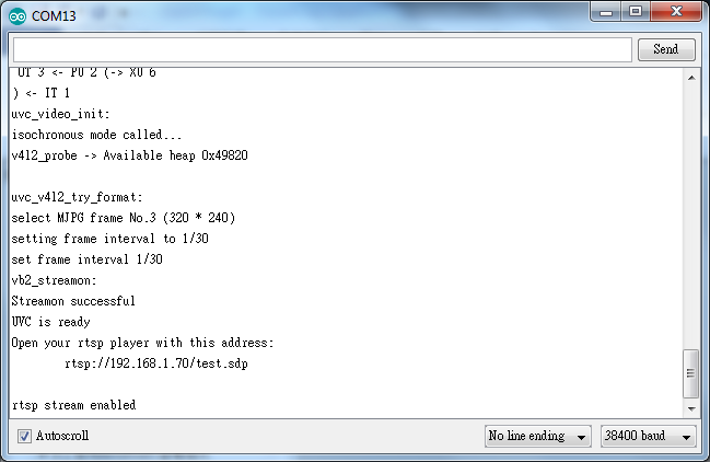

Then open the Serial Monitor:

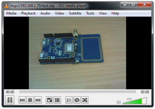

You can see that we are using the default MJPG (Motion JPEG) with resolution 320 * 240 and frame rate 30. After the settings are done, the log message prints the link for the streaming: rtsp://192.168.1.70/test.sdp

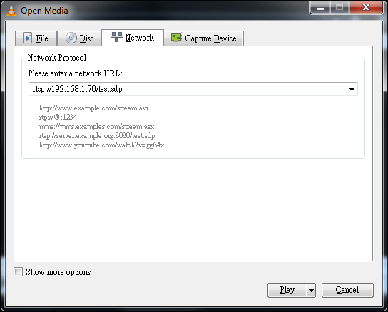

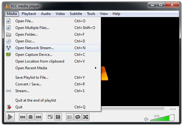

Next, we use video player supports video streaming, e.g., VLC Player - http://www.videolan.org/vlc/
Open VLC player, click "Media" -> "Open Network Stream"
Fill in the link of the streaming, (Please make sure the computer and Ameba are connected to the same wireless AP)

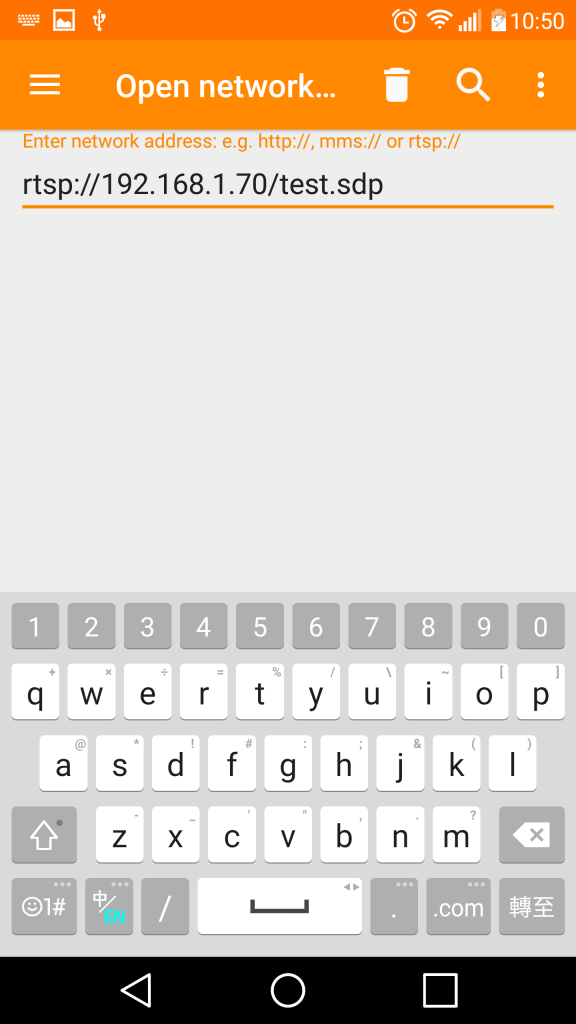

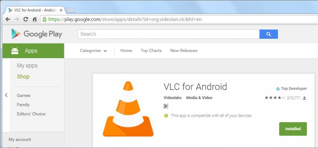

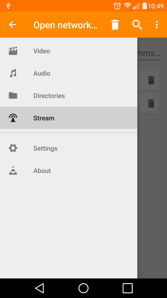

VLC also provides application for smartphone:
Click "Stream"
Enter the link, and make sure the smartphone and Ameba are connected to the same network.
