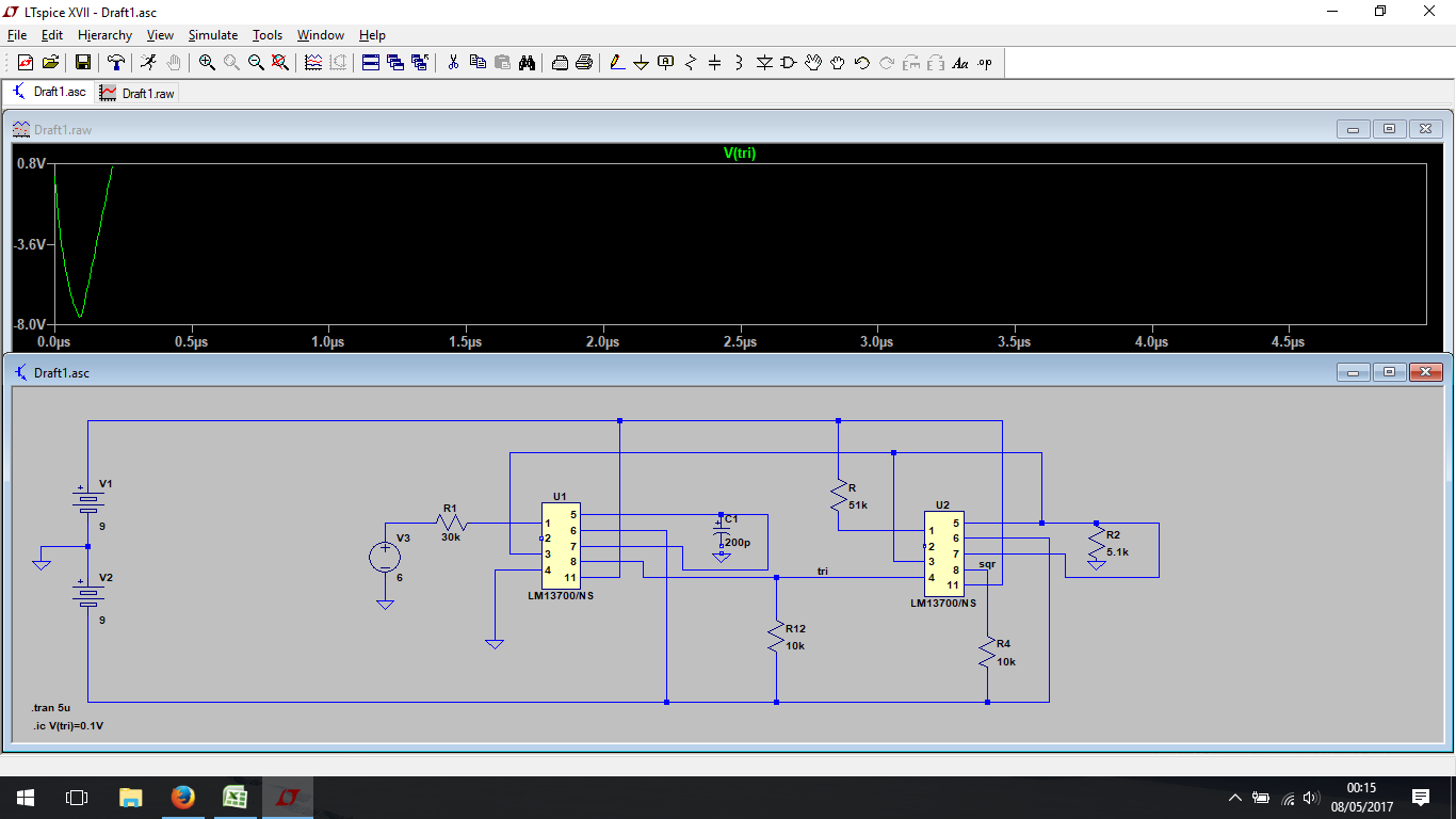

Hi guys,
I'm having an issue simulating the LM13700 in LTSpice.... I have trawled through the net to no avail.
It's a standard setup for the LM13700 from the data sheet (Square/Triangle VCO) and I have some initial conditions which can be seen in LTSpice, to help kick it into oscillation (it stays flat at 0V and -1.3V otherwise) .... and the output I get is below (only runs for a fraction of a micro second)
any ideas on where to go with this, why doesn't it display the waveform for longer? I'm stumped..

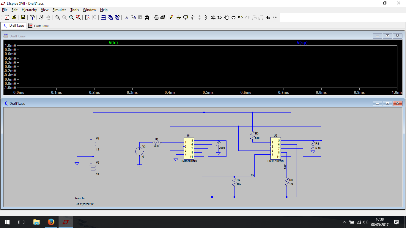

there was a small mistake in the original, where I hadn't connected the capacitor to ground....
I've fixed it but now it doesn't do anything o_O
I also attached the asc file.

update: although no errors show when I run the sim, when I check the error log, I do get this error... any ideas?
Direct Newton iteration failed to find .op point. (Use ".option noopiter" to skip.)

Ok, so taking the advice of the logfile, I skipped the.op point.... however I get a new problem...
Direct Newton iteration for .op point skipped.

Like you, I failed to get your sim of the VCO in the datasheet to run. However, it can be made to run with the following changes (I daresay other changes would work too):-
1) Reduce V3 to 1V,
2) Increase C1 to 100n,
3) Add the directive ".options gmin=1e-7" to the schematic.
1) Reduce V3 to 1V,
would the 1e-7 not give false results? (I remember reading somewhere not to really go past 1e-9)
Harald Kapp
Nov 17, 2011
14,317
Nov 17, 2011
14,317
Better some error with 1e-7 than no simulation at all with 1e-9.
As with all simulations you have to take the result with a grain of salt anyway. The simulation can be only as good as the models used and who guarantees the model of the amplifier is as accurate as you expect?
My personal stance is that the simulation is only there to verify there's no fatal flaw in the design calculations. A prototype will show the real world behavior much better than any simulation, including hard to simulate parameters such as e.g. noise, PCB Layout parasitics etc.

Hi
The input offset current is modeled with an F device poly which doesn't converge very well.
Change the following in the subcircuit definition:
IS:
F1 4 3 POLY(1) V6 1E-10 5.129E-2 -1.189E4 1.123E9
Change to:
*F1 4 3 POLY(1) V6 1E-10 5.129E-2 -1.189E4 1.123E9 <--comment this out
B1 4 3 I=If(V(11)>1.4v,100nA,0)
