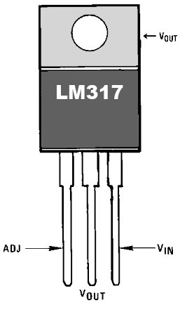

Why is the pic of lm317 showing pins different to the circuit pic you added ,vin on left side of lm317 vout right side of lm317 and adj middle can you use different pins as adj? I just fried a 10k pot after i put together that circuit with vin on left vout on right and adj middle now I am even more confused!!!! why do the drawings show it that way if its not that way ?
because as I was explaining, the way your original circuit was drawn by whoever did it was totally non standard layout
when drawing circuit diagrams, input is always on the left and output on the right
you still physically wire the regulator as per the regulator pic I put about the circuit layout ....
personally, I think, the person who designed the LM317 should be strung up for designing the pin layout the way he did
