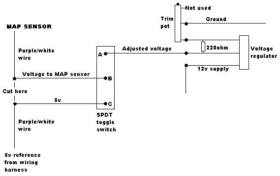

What I did was put a 1000ohm 15 turn variable resistor on the LM317T. I'm putting battery voltage to the regulator (which is the reason for the post, battery voltage varies) to get 5.5V output. I'm tricking the MAP sensor to produce the same signal as a 2 bar sensor. I use HPTuners to tune my car (I added a supercharger to the engine), and my custom OS can't see the top of the range of a 2.5 bar MAP sensor, which is what came with the supercharger.
But, I'm having an issue. It will only dial down to 10.2V, and then it drops to millivolts, which I'm guessing is actually zero or near zero. If I turn the resistor clockwise, the voltage increases. So do I need to add a resistor to the ground to get it to go lower? The heatsink when the voltage drops off gets VERY hot, so it's obviously turning the entire battery voltage into heat, right?
I'll try to draw my circuit so you all can better critique it.

This should give slightly under 5V out.
The temperature will depend on the load current.
A buck regulator may give more problems if is is noisy.

Thanks Duke. If I wanted 5.5 volts, would I put the pot where the 560 ohm resister is?
Load current is supposed to be less than half an amp according to the spec sheet.

Yep, you place the pot where you indicate.
Note that the LM317 will need a heatsink, and the tab needs to be insulated so it doesn't short out to anything.
If the LM317 gets too hot it will shut down.

Your circuit diagram was correct. If you can set your 1000 ohms to 750 ohms. You should have 5.51V as output.
Can you post picture of LM317 and connecting wire. Pls label wire for
Input, Output and Adjust wires. There might something you missed.:)
