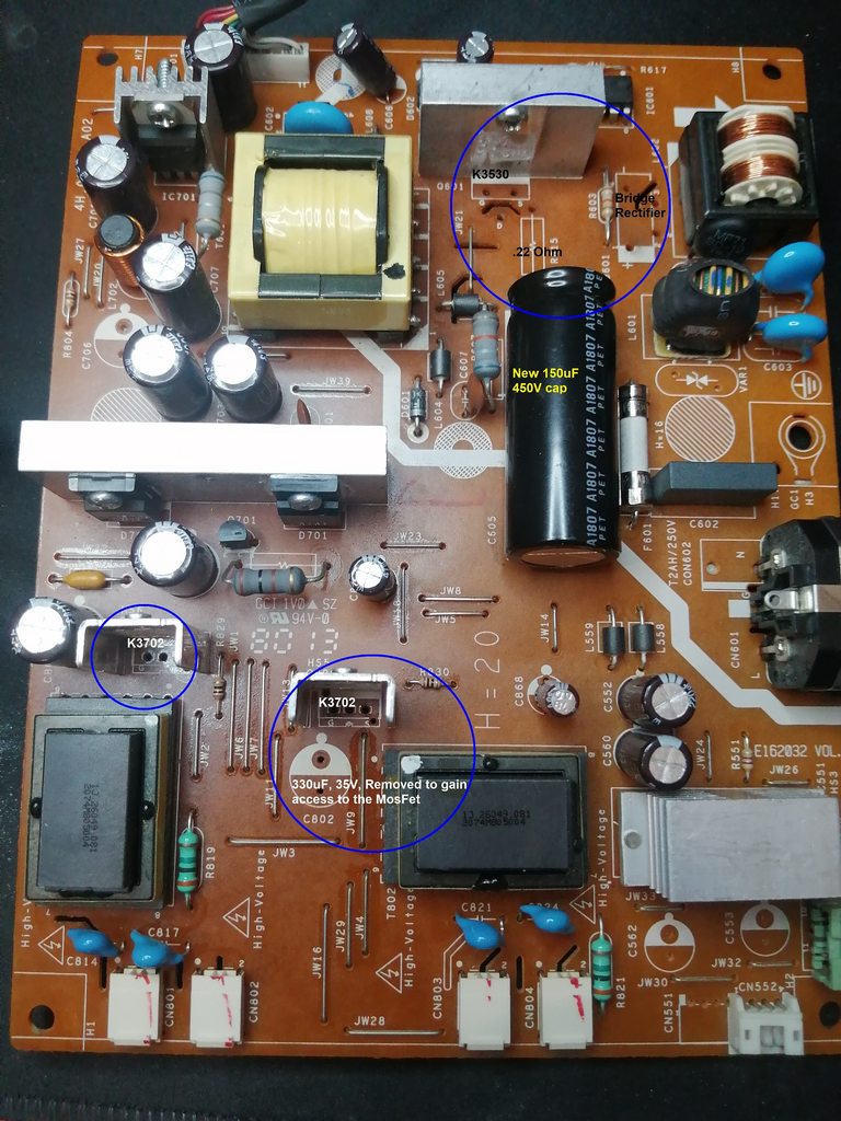

Here is the photo of the board with MosFets removed for testing, only the K3530 is short circuit and the 0.22 ohm resistor is open circuit (burnt). The bridge rectifier tests OK as do the other 2 MosFets and the removed cap as well.
I was unable to locate a new 120uF 450V cap, so I replaced with a 150uF 450V, this shouldn't make any difference, should it?
Does this help you at all?

Check the switcher isn't dead, number on top should direct you to a Google spec. (ic601) 1/3 way in RHS top.
Is there a way that I can test this IC601 without powering it up then or do I need to provide external power from a bench supply and look for an output?

Check the number on Google for spec sheet and that will show what is inside the chip. Then you can test for shorts etc with no power via a standard multimeter.

Just replace IC601 anyway - far simpler and, if you're ordering parts anyway, only a few $ (or less).

Sir specmaster . . . . . . (+ or - 2 nanovolts ? )
I consulted post 7 . . .observed photos . . . . .wiped drool from my lips.
You have that single pulled power FET that drives that main power transformer to its left for giving 5 V standby . . . . . ALL of the time that the unit is plugged into AC wall power.
Seems like an additional 12 VDC is also derived .
Down at the bottom are two additional power FETS that also drive those two black inverter transformers that create HIGH voltage to drive your sets of back light mini Compact Fluorescent Lamps .
Leave those FETS uninstalled as they are initially of no concern to us.
I may have found a close enough ASUS schematic . . . a model 198 . . . . to work with . . . . give me their driver IC and it may be on bottom of chassis feeding their gates . . . . .packaged as a mini flat pack configuration.
NOW . . . in going back to your principal power supply . . .
Any chance that IC 601 . . . .an 8 pinner I.C. . . . . . is being a TEA1530AT . . . . if so, its Pin 6 outputs as gate drive to the frontal POWER FET.
BUT with that low ohmmage source fusible / resistor being open, a HELL of a source power hit it to open it, and with you possibly now finding a fused internal source to drain die . . . . that is now testing as DEAD shorted.
If testing as open, it may have all vaporized internally. If all melded together internally, initially, one could suspect the merged gate to source to drain, confluence, to have sent hundreds of volts backwards into the driver pin 6 to blow up its internal driver section.
If your unit uses a different IC 601, pass it to me, let me look it up.
Considering you also having AS MANY Ole'- silly- scopes .
EVALUATION . . .
. . . with no POWER FET reinstalled . . . . . upon A.C. power plug in, that I.C. should put out a serial burst of start up pulses to drive the FET initially. Then a dedicated run winding on the transformer outputs its low voltage power to a diode to be filtered an then that supply is the continual run voltage for the chip.
So if you scope pin 6 at AC power plug in time and see a numbered timing of start up pulses, you were / are LUCKY !
Then you get busy and put on yore BIG BOY pants and put in a good POWER FET and pull the fuse and use 2 hook up wire lengths to wire in a 60 watt incandescent lamp, in place of the fuse .
Power up with AC power plug in and see that the lamp doesn't go to FULL brightness . . . .instead it just having a possible, low glow.
More importantly, clip in and DC voltage monitor any one of the low voltage supply E-cap output filters at circuit boards top left corner. A slight voltage build up on it would indicate a successfully activated transformer output and the derived / but / being of a reduced voltage.(For such a short activation time )
And then . . . . .AND THEN . . . .AND THEN . . . . you might go for it . . . and try with the fuse reinstalled . . . to see if the monitored voltage COMES on UP.
Fill me in . . . .

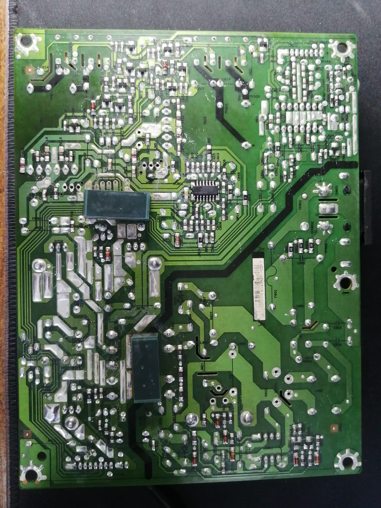

Ok then, the IC801 is a OZ9938GN there is no connection between pin 5 and the Gate of the MosFet, probing with my Fluke 85 these 3 parts are completely open circuit

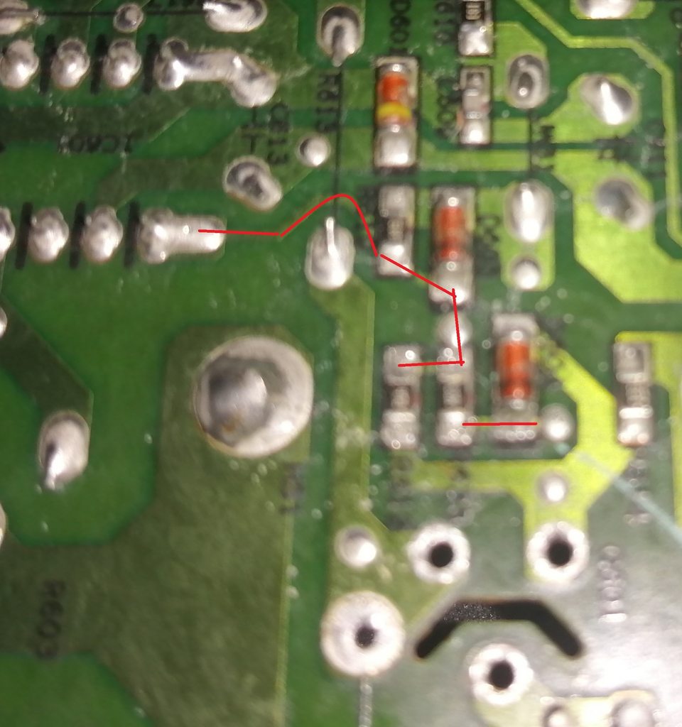

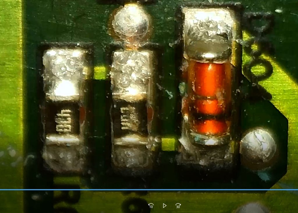

The three parts are respectively from left to right R612, R620 and D604, 2 resistors and a diode and there is continuity along the red line to the feed end of R612 and R620. R620 and the diode D604 are in series and the end of the diode and R612 terminate on the foil that connects to the gate.
specmaster
Dec 28, 2019
33
Dec 28, 2019
33
Correction to the above message, I must have had my meter in diode test mode, so my bad. Right, selecting diode mode on the meter, the diode seems to be ok and giving a reading of 0.6V in one direction and O/L in the other, so that appears to fine.
Switching over to resistance mode, R612 reads 53K (in circuit) and R620 (should read as R623) is open circuit and as a double check, the diode in resistance mode is reading 1.5M with negative to cathode and O/L with positive to cathode.
According to my research, so far, the 470 on R612 equates to 47 ohms so with it reading so high in circuit is an indication of it being either open circuit and the 53K is via another path through other devices, or it is badly damaged and reads that high so needs replacing.
R623, I'm unable to decipher what is written on the top, so currently clue less as to what its value should be.
I'm looking for the other manual you found (VW198) to see if that could provide a clue. Will report back later when I find it.
