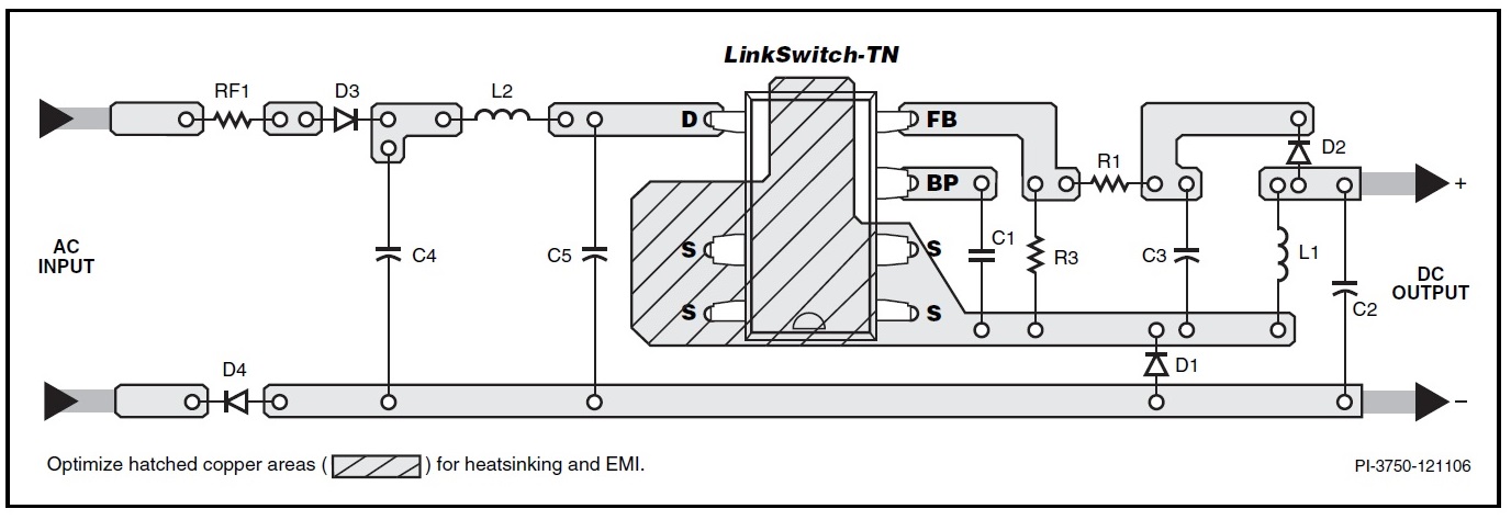

Hello everyone!
I'm looking for help in choosing components and preparing protoype board with use of lnk306 chip.
What I'm looking into is following :
  • Understand why choosing specific components and not just copy info like monkey
  • Make device that will be safe to use at home (target is to use in light switching scenarios)
  • Survive this project without damage to my health or life
  • I would like to get output of around 5V to power mcu (probably Atmega88) and RFM69CW
I found pcb design that I could make use of
However I might be wrong in finding information in DS because I seems to miss information how do I set output to 5V ?
Input will be 230V AC
Looking forward for your comments

Raf,
If you can, it's helpful to provide links to information that EPF members will need to answer your questions. The person who may best be able to help you may not have time to go try to locate this information.
I'll try to help with this:
The Lnk306 is a product of Power Integrations, http://www.power.com/.
Power Integrations make many different sorts of power supply chips, many of them intended to take power from the AC line (mains). I have had good results using their devices. If you are in the US, Mouser sell these. Less than $2 for one.
General information on the Lnk306 is here:
http://ac-dc.power.com/products/linkswitch-family/linkswitch-tn/
This page includes links to much more information on using this device.
The data sheet is here:
http://ac-dc.power.com/design-support/product-documents/data-sheets/linkswitch-tn-data-sheet/
An app note is here:
http://ac-dc.power.com/design-suppo...cation-notes/an-37-linkswitch-tn-design-guide
The above links should lead you to information about choosing components and setting the DC output voltage.
Before getting too far along, you need to be sure that this part is a good choice for your application.
It is clearly intended to provide a small amount of DC power where isolation from the AC line is not needed. Your low voltage DC output is connected to the line and is not safe to mess with. Any microcontrollers or other devices connected to them will also be "hot".
Most hobby projects would be powered much more safely by a small isolated power supply, possibly a "wall wart" style.
Another consideration about the Lnk306 is that it appears to have a rather loose output voltage specification, at least when using the more basic application circuits. The regulation may not be the tightest, either. Probably it would be good enough, but we don't know much about your requirements.
Other Power Integrations parts might be better choices. Some are intended for use in transformer isolated power supplies.
To answer your question about setting the Lnk306 DC output voltage, it is set by resistors R1 and R3, as seen in the recommended PCB layout drawing in your first post.
In the circuit, C3 is charged up to about the DC output voltage while D1 is conducting, which will happen just after the power switch in the Lnk306 turns off. R1 and R3 divide the voltage on C3 to feed the FB pin.
The chip drives current pulses into the load until about 49uA of current flows into the FB pin. This will occur when the FB pin reaches around 1.65V above the C pin. Once the FB pin sees this current, the next current pulse is skipped.
See page 9 of the data sheet.
Risking looking a bit like a monkey, one could use the 12VDC / 120mA output circuit shown on page 4 of the data sheet, but reduce the value of R1, to get your 5V output. You'd want about 4160 ohms.
Ted

Hey ,
Thanks for the detailed information. So to put maybe more detailed project clarification this device would provide current for uC teamed with RFM radio and would be sitting in my room lamps. At least that was the assumption.
Now more I read about this it seems to be less useable :) for this. Goal of this project would be to have small AC=>DC to provide current for uC to switch/dim high current. Reason why I didnt go with wallmart style of power units is I would like to be able even for my self to manufacture them in their small factor size.
Ted are there any other alternatives you are aware about that I could potentially use ?
Also I have used PI expert program to calculate values I need to 5V - altough I have choosen to full wave rectification which means I would need to use a bridge ?
