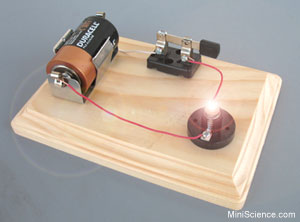

Hi all,
I'm a middle school science teacher looking to introduce an after-school science club into electronics. I've only just begun diving in myself, but I want to initially have them use Ohm's Law to calculate the amount of resistance needed to light various colored LEDs using regular AA or C/D batteries.
My question is this: I'm looking for a cheap way to make a "circuit" board...a way for them to connect wires together as they choose. I was thinking that taking a thin wooden board and installing screws in a grid pattern all along the top would give them a way to loosen the screws a little and then and put the wires underneath the head of the screw to hold the wire in place.
Something similar to this:
Is this an even remotely good idea, or would touching the exposed screws/wires in the circuit be a recipe for electrocution by battery? Thanks in advance.

Working with LED's will require you to use 1 to 3 batteries depending on the color you want to light.
Even with 3 AA batteries, the exposed wiring will only be a hazard if the student shorts the battery, the wire could get hot and cause a burn.
The voltage is low enough that you need not worry about electrocution. The students could lick the wires and receive a ticklish to painful sensation on the tongue, but that is about all.
As far as your idea is concerned. Panhead screws, and perhaps a washer will allow the students to stick in two or more wires and tighten the screw to make a connection.
Otherwise you could invest in breadboards. (simply stick the parts in the holes and be done with it.)
What is the target age group for the students?
if its just for an electronics club, yeah I would see of the school would invest in a couple of proper breadboards
like this.....
here is a pic showing Gryd3's screw and washer style idea .....

The breadboards dont need to be full size either.. They could be half size, and cost anywhere from $2 - $5 depending on where you buy em.
They would not require any tools to assemble... stops kids from loosing screwdrivers... or stabbing things with them
You should probably expect to loose a large number of LEDs as well... Kids enjoy watching them change color and start to smoke when you apply too much power. (ie... the green ones fade to yellow and red before going dark and letting smoke out)
