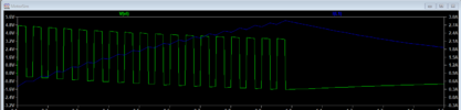

If i give a pwm signal for the LR circuit with 50% duty cycle, during on the ON time the current will increase and during the OFF time does the current decreases and reverses its direction during the OFF period or it only decreases. My question is mainly on why the current does not reverse?
And my question is, why do you think it would reverse?
What do you understand about inductance and how inductors behave, that would lead you to think the current would reverse in your circuit?
It would need a voltage source in the reverse direction to reverse the current.
That can occur in an LC resonant circuit, where the capacitor generates the reverse voltage as part of the resonant oscillation, but there is no capacitor in your circuit for that to happen.

Thank you all for the answers, it is always confusing how many times i read, understood for now that current only decreases does not reverse. The initial thought was when voltage signal is applied the current increases in the inductor, and during the OFF period the inductor had to discharge the energy and assumed it will send through the resistor in the opposite direction.
The mechanical analogy of inductance is inertia.
The inductance tries to keep the current flowing in the same direction until the inductive stored energy is dissipated.
That can cause the voltage across the inductor to reverse, but that just serves to slow down the current, not reverse it.
