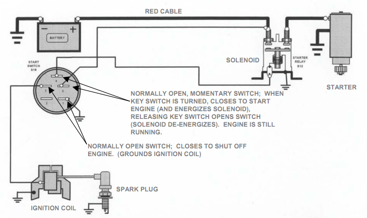

Hi Bob.
That cannot be. Would put high tension to the keyswitch while running in order to be grounded when keyswitch turns off.
It is about a wire coming out of the magneto which is not high tension, grounded by a lever if operator releases grip of a push mower or turns key off on a riding mower.

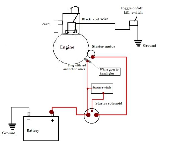

On simple magneto-generators, as used e.g. on motorbikes, I think the kill switch merely short-circuits the (low voltage) generator coil that powers the ignition circuit.

That is how it works on lawnmowers too. The switch shorts across the magneto coil and the spark plug which are in parallel.

A transformer has a primary winding which generates a magnetic field in the iron core and this is coupled to the the secondary. The output voltage is proportional to the ratio of the turns.
In this case, the magnetic field is produced by the passing magnet. The voltage is generated in the two windings in proportion to the number of turns. Shorting one winding forces zero volts on the other winding - engine stopped.

The bottom 2 pictures are of a Briggs & Stratton ignition system. Theres a primary & a secondary winding in that coil with an electronic module built in. The Kill switch again shorts out the primary winding to stop the engine.

There will have to be a method of opening the winding at the critical time to get the spark. In the early car days, the contacts were opened in the cylinder and an arc was drawn at low voltage. Later a set of points were opened in the primary of a transformer to induce a large voltage on the plug in the cylinder.
In this case @debe says that there is an electronic module in a B&S engine to do this. The energy in the inductance is then diverted to the spark.
