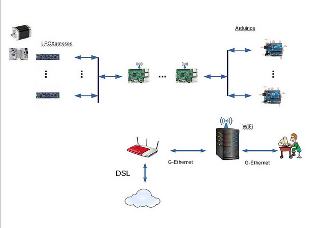

The text in the graphic was targeted for spanish speaking audience, sorry. So deviating from the hardware modules shown in the block diagram I am using for my experiments a RaspBerry Pi board to control the LPCXpresso board listed.
So I had no problems to have the Raspberry Pi desktop to show up in a window on my PC, then using Windows 7 Ultimate 64 bits. I did use ssh, secure shell to establish the communication between the PC and multiple RaspBerry Pi boards. I was also able to have the PyCharm IDE running on my PC, that generates Python code to be executed on the RaspBerry Pi, short Raspi, by defining as the remote interpreter to be the one running on Raspian Jessie on my Raspi boards. I also do want to mention that I do have my Windows constantly updated and have powerful protection software suite in place. The starting point of my failure was to publish de Raspi boards on a DNS supplier in the internet, so that I was able to have the DNS to assign the proper IP ID to a communication.
Via the Internet and the Raspi communication link between the Raspis and my PC the attackers were able to render my PC inoperable! The good in the bad was that as all my intents to repair Windows on my PC failed, I did take advantage of Microsoft's offer to have my Windows OS updated to Windows 10 Pro , which then did fully operate again. Just for your entertainment here a picture of my electronics lab which is next to my office desk in my workshop:

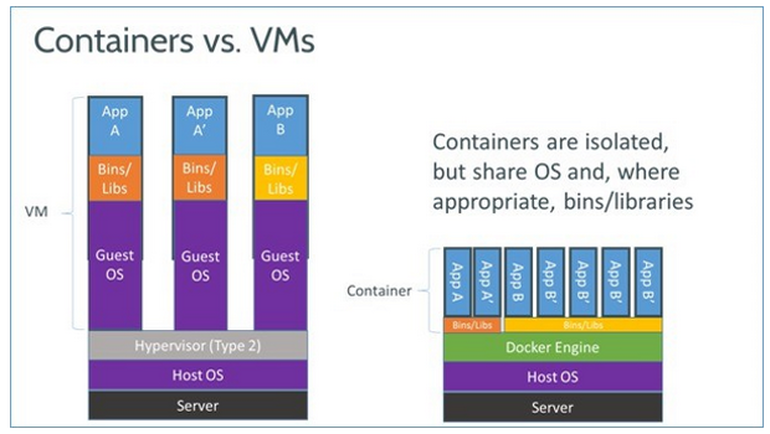

This picture illustrates the concept of Containers versus virtual machines! Containers generated using Docker run on top of the host OS and of the Docker engine, but each container does contain only those resources needed to execute while not replicating the entire OS as it takes place in a VM! But while VM's offer the best isolation and in consequence the higher safety compared with Containers whose isolation is more similar to that of one application to another application being executed within an OS. Well known to be much weaker. Due to the paramount importance of safety in devices connected to the Internet and how scarce hardware resources are in an IoT compared to a full fledged PC, a hybrid is being researched for to combine the benefits of both.

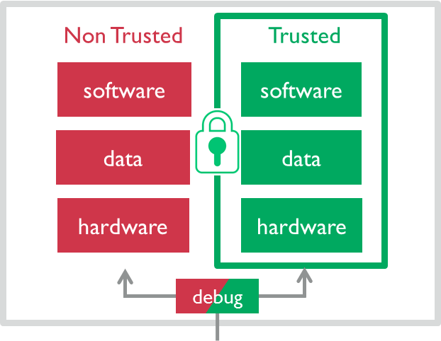

Finally I want to include in this contribution that the requirement of safety is making research and implementation of technologies to achieve safety in devices connected to the Internet an activity with very "deep pockets"!

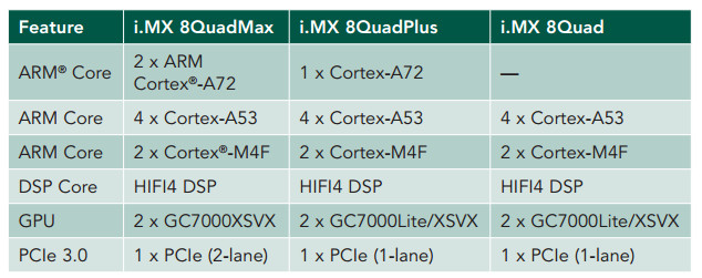

All major providers driving the development of technologies have their way to it, but as devices in the IoT and IIoT dominantly are based on controllers based on ARM technology. The core of this technologies is to have 2 different environments, Trusted, here in green, and Non Trusted, here in red. Non Trusted is microcontroller functionality as we all are aware of. If we take the Raspis as an example. Linux runs in 2 privilege modes. One being the user mode as we know it from any operating system and one is a privileged mode in which Linux kernel is executed and which enables the OS to administer the use of system resources by an application and protecting the execution of the applications by preventing them to interfere.
For the Trusted Zone ARM has defined a new even higher priority level and its execution alone allows the use of special instructions which operate on the special hardware resources available within the "TrustedZone" has the concept is called by ARM. A hypervisor is the one that executes code in this highest privilege mode that allows for efficient operation of VM's! The first 2 ARM Cortex M controllers published and licensed by ARM are the ARM Cortex M22, which is equivalent in performance to the ARM Cortex M0 and M0+. The ARM Cortex M33 is the one equivalent to ARM Cortex M3 and M4! The one most visible to me is the implementation of this technology by NXP Freescale and its i.MX8 product family. NXP is mainly targeting the automotive marketplace with this products and as a consequence the i.MX8 that comes in the following flavours

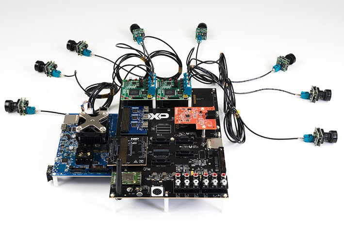

represents a device of a complexity far beyond what we are used to. This is on one side reflected by the hardware functionality shown in the table and can be, to my believe. better visualized seeing their Multisensory Enablement Kit offering:
This complexity is due to the fact that it enables to create one central Unit for multiple functionality present in current top of the notch cars and those to come in a relatively close future. Development requires different engineering skills for different functionalities offered within the controller! Former Freescale announced this controller a couple of years ago and is closely working with selected tier 1 customers to use their device in the automotive marketplace. Just very recently a company that offers inexpensive boards using the previous generation controllers, i.MX6 and i.MX7 has announced to have a board in its pipe with the i.MX8.
But this complexity also demands from NXP to deliver IDE and libraries and application notes that make the implementation of this multiple functionalities possible to smaller engineering groups. While NXP had announced the availability of its i.MX8 devices sometime in 1Q17, this has not yet taking place. No wonder as to be ready to help interested customers of tier 2 and beyond demands a different class of support that has to be equivalent to the level of support we have been familiar with other products in the market. I believe this to be the reason for the still continuing delay of the general market to have access to this product!

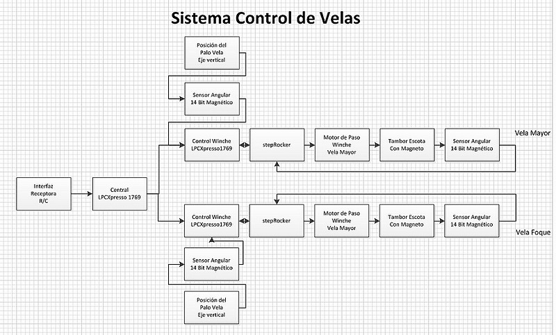

As I wrote, one is enough to continue, thanks! You are right, my studies and experiments belong to me and it is my hope that by sharing them openly I can return the help I have received a little bit!
As you addressed a kind of Top View" I would like to respond as I do believe electronics has a lot to contribute to naval modeling, much easier then with building planes models. The latter are very sensitive to malfunction and timing, naval models are more forgiving and can contain an infinite number of functionalities that electronics allow to build the way the modeller has in his mind. Benefitting for the possibilities of communication development this was a relatively early topic I have dealt with. I warn you, as always for me, I am lengthy!

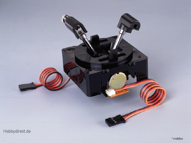

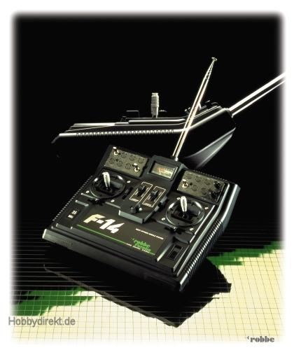

I started and still own a R/C system from the german company "robbe" that operates as required by law in Germany at 40 MHz:
This R/C equipment, the F-14 does exist in a special naval version that has one of the control sticks replaced by:
For sailboat models this is perfect as you can control the position of 2 sails independently, putting the 2 sticks next to each other you can activate a switsh that connects both sticks to operate as one.
and for proportional controls:
I do own the one on the bottom that has 8 rotating knobs. To say it directly: a total mess! One of the first things I did when I build the first device to digitize the PWM signals coming out of the 8 channels of the receiver was to analyze it. What it did in a unit that you plugged into the receptacle of the receiver and which in turn offered 8 receptacles to connect i.e. servos it, and believe me the price was outrageous, was to send in 8 consecutive cycles of 20ms each, as usual for R/C receivers, the control PWM for the individual knobs and repeating it. The unit connected to the receiver just generated a PWM extended to 160ms. the result was bad operation of the servos connected and nearly no torque. All I had to do was to leave the even more expensive unit in a box and make a small module with a mega8 controller that read in the signal of the receiver and so manage to generate 8 PWMs at his outputs, each with the correct 20 ms cycle PWM and just updating the PWMs individually every 160 ms.
So having wasted a lot of money buying those expensive units from robbe was the starting point to make my own electronics for my naval modelling.
So in my R/C transmitter I did install the 8 proportional control knobs and the 8 multiswitches in the 2 areas left and right of the power indication of the transmitter.
The the 2,4 GHz R/C systems changed the technological platform of R/C systems making it possible for chinese companies to offer R/C systems and ridiculously low prices on one side and on the other side the vendors of R/C systems to offer ridiculously high priced computer transmitters and expensive units to interface with actuators and sensors and to display the data generated on their small black/white screens, still characterizing their R/C systems by defining how many "channels" their transmitter were now able to offer! What a marketing scheme to continue charging premium prices to their customers, when the 2.4 GHZ technology is a serial bi-directional data stream"
So my concept was to combine a 10" tablet placed in landscaped position, today that could be a smart phone with electronics, so that still such a transmitter has the familiar control sticks, 1 to his left and 1 to his right. In a row above that display 5 switches, in a row below 5 rotating knobs. The display would best have an Android OS and the display device a USB port to connect the external circuitry to the display. Android is better than other OSs as right from its provider it offers the tools to have an app running on it communicate via the USB port to external circuitry. Android when I started looking into it was still in a 3.x version but it was foreseeable that later versions would be even better suited for my purposes. Now comes the great thing about it:
The user would have HMI with the functionality he is used to from smartphones and tablets and prices for tablets would be falling dramatically, as it actually happened. Now the more limited number of switches and rotating knops would be assigned their functionality depending of the actual window being active. So, as a single motor plane pilot, multifunction displays in the cockpit was being discussed in those day. The screen has a "main window" that allows full control and small windows that just present key information. Should one of the auxiliary windows require the attention of the pilot it would either signal it by blinking or would take the place of the "main window". So those "soft switches and knobs" make it possible to assign them unlimited number of functions, depending on the "main window" being active. As tablets were still too expensive in those days I did change the focus of my activities to electronics within the sail boat model.

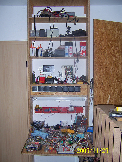

As you can see there are 7 power outlets and a switch. I do believe you have never enough outlets!

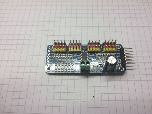

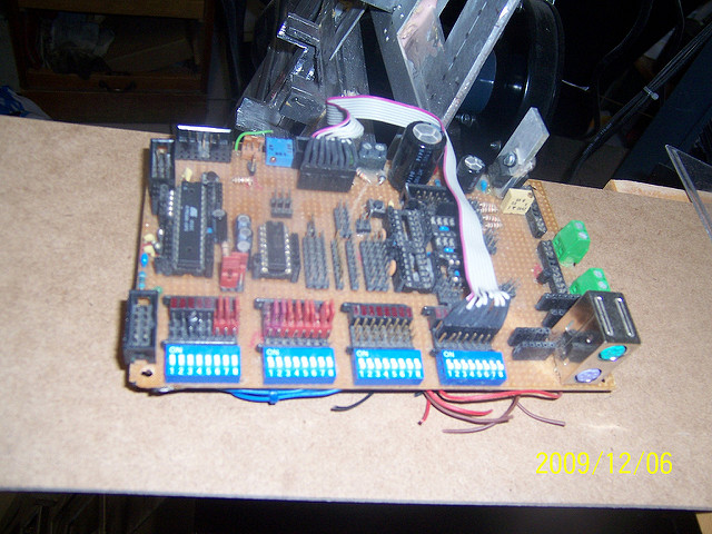

Here you can see "my experimental board" expanded. A friend of mine developed a tutorial to make it easy for naval modelists to take electronics as another technology offering infinite possibilities in their hobby and to overcome the intimidation that electronics has on many of them. Interestingly the modelists of planes did jump in much bigger number on this tutorial.

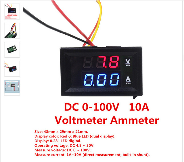

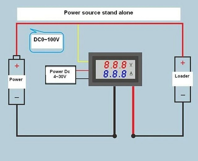

Wandering around the internet I found this item:

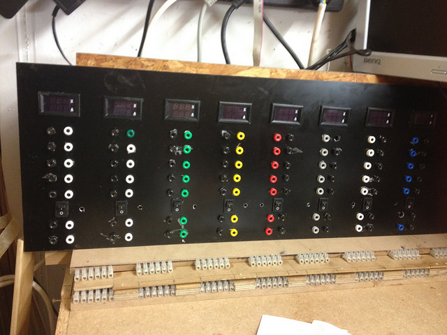

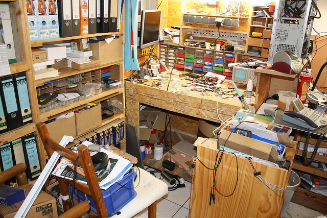

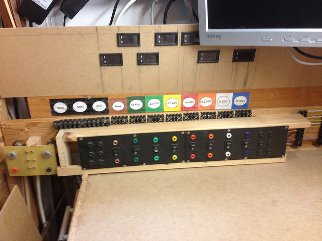

In the first photo, you see my electronics workbench and on the left side of the desk what I call my panel 2nd generation. This panel is fed from my modified pc power supply offering me a total of 8 different voltages. Seeing the above device I decided to have one of these devices above the receptacles for each of the 8 voltages supplied. My first design idea is shown in this photo:

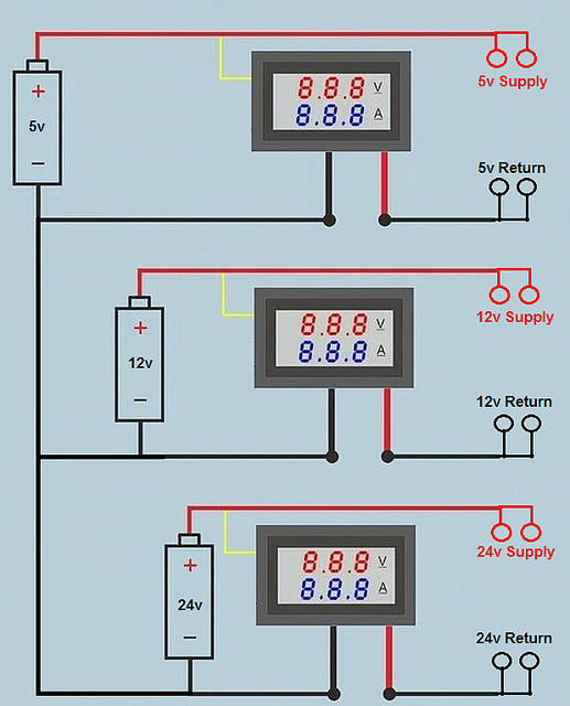

But moving on with the project of a 3rd generation panel I decided I did not like a solution the way shown here! But even more, the serious reason was that the display with the current and voltage monitoring did measure the current on the negative pole. My 2nd generation panel placed the receptacles of the positive poles and had the 2x 6 black receptacles used jointly for all voltages.
This means I have to make ground receptacles for each of the voltages of my panel. Something like this:
My panel 2nd generation had 1 colored receptacle below a switch that was always available, while the receptacle above the switch was turned ON/OFF by the switch. Additionally, I had 5 screwable connectors on top of the panel and added a bunch of negative pole connectors on the left side.
So I decided to make the panels 3rd generation as shown in the work in progress above. I did now have 2 connector pairs below the switch and 5 above controlled by the switch as it was done in the panel 2nd generation. As you can see in the photo now there is enough space on the panel to have a display above each of the voltages. Also, you see that now there is always a positive and a negative receptacle next to each other. To the right of the switch, there is a 5 mm diameter hole in which I will place an RGB LED. The screwable connectors are now placed below the panel. 6 screwable connector pairs, above the positive pole, below the negative pole. The RGB LED will get on when the switch in its "ON" position.
serveimage
Each RGB LED will display the color coding of its respective voltage. I have chosen the color coding from the color coding for PC power supplies. 8 RGB LED has each 3 pins that need to be driven by adequate PWM values so the proper color is achieved. The above photo is a board that offers 16 PM outputs. So with 2 of these boards, I can generate the PWM 24 signals required. These boards are controlled by a single RaspBerry Pi ZERO W. I take this Raspi because I Want to have a window on my Windows 10 Pro PC desktop to control the RGB LED, not just the color, bad also be able to dim them. So the Linux Desktop running on the Raspi will be in this windows on the PC with an application running on Linux to control the RGB LED remotely via the WiFi functionality. Additionally, this Raspi will control and monitor the electronic fuses I am building using MOSFETs. They will be monitoring the currents flowing from the power supply to the panel using the resistance of the MOSFET and switch the MOSFET OFF if a value I define an upper limit for the current is reached.

For someone with limited workshop space your approach towards a power supply seems rather confusing.
A power unit with dual VARIABLE outlets would be as much as you might need for all your experimentation. Many experimenters workshops will have such a supply AND NO MORE.
Individual systems (that you may be building) would normally have a single source to power them anyway and any sub-supplies would be derived internally (on board) from that single source.
It's called 'simplification' and/or 'minimalising' - something your work seems to be missing! I see (and read!) that you have over engineered the potential solution by a long way. All you're going to do is make construction and fault finding exponentially more complicated and time consuming.

@kellys_eye: You are absolutely right... if my purpose was finishing something and do it efficiently! Let me respond to what you write in your last paragraph: What characterizes a German engineer? Why do it simple when you can do it complicated. And so is the issue with all my projects: It makes fun and it gets me in touch with topics I would have never met if I would not do it my way! And you know what? I find my panel 3rd generation nice. Just take as an example my dealing with security in embedded systems. 3 years ago I went to a trade show called "Embedded world" in Nurenberg. Due to my researches and studies and experiences in my own workshop, I knew that security would become a major issue. In the show, I just met one engineer that knew what I was talking about. A year later this topics was in everybody's mind at the same trade show. For more than 3 years I am studying and experimenting with the topic of security. Sadly my health problems do slow my efforts down more and more.

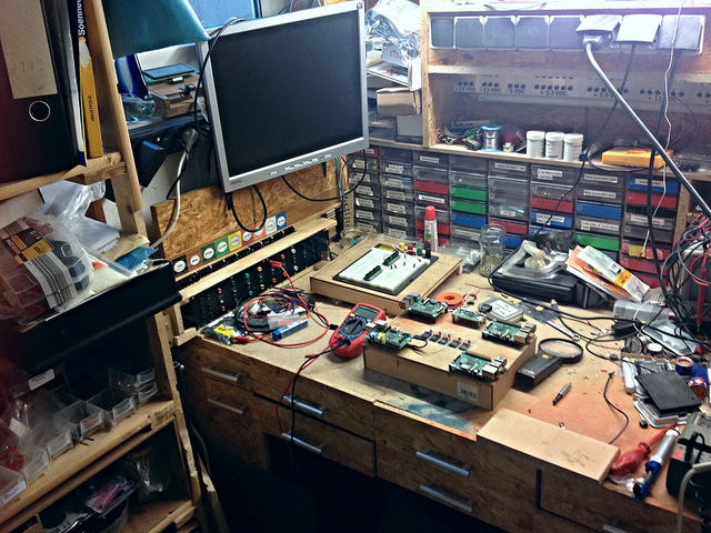

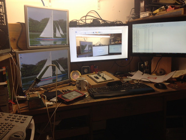

Here a photo of my electronic corner of my workshop

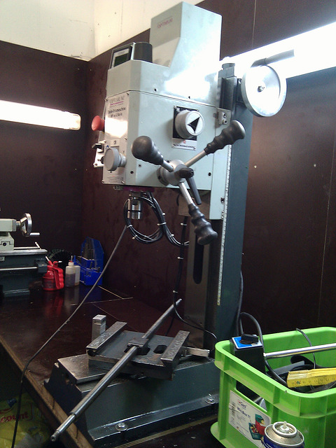

Here a picture of my tower milling machine. It is, together with my lathe what I call my new workbench:

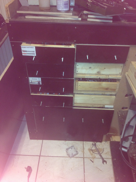

Here a picture of the drawers in construction below the tower milling machine.

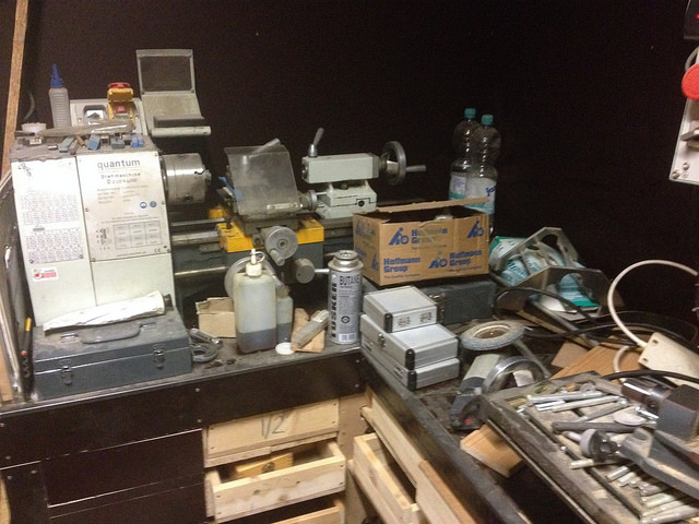

here the drawers below the lathe in my new workbench:
Here my lathe:

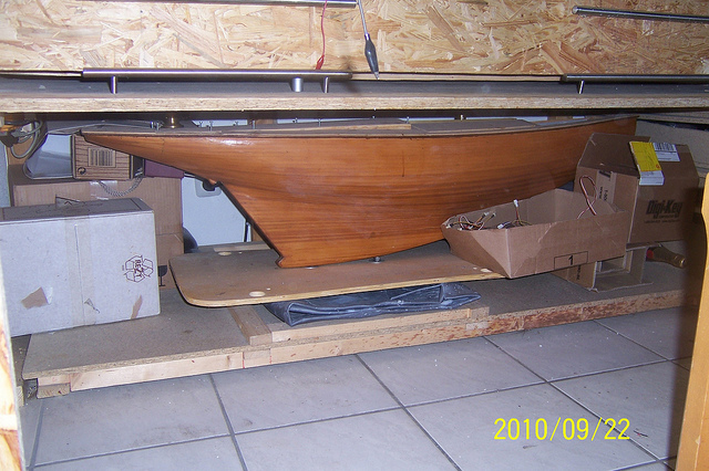

Here space below my old workbench where I made a "hangar" for my sailboat hulls:

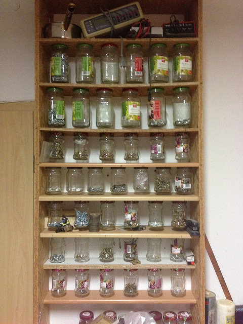

Here the shelf to store screws and other stuff in a visible manner to know what choices I do have due to my existing inventory.:
