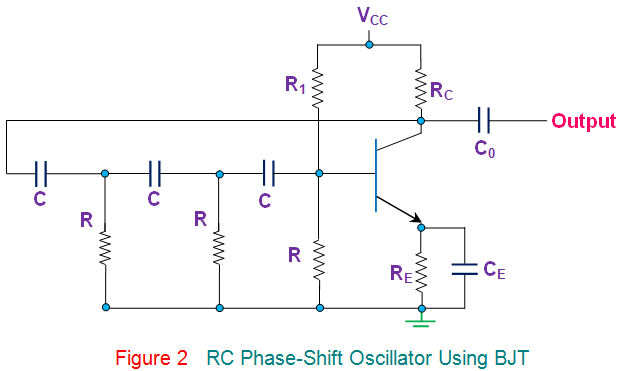

Not sure how you can say that. I was winging a guess based on an incomplete, two-sentence description with no schematic. Based on only that, a string of resistors and capacitors and one transistor still sounds like a phase shift oscillator to me.
ak
The circuit above is really a phase shift oscillator. The 3 caps and resistors shift the phase 180°. The loss of voltage across the 3 RC network is compensated by the voltage gain of the common emitter transistor.
The circuit presented by me has no phase shift and actually amplifies the input voltage slightly. That means it can be used in a common collector transistor configuration which, as you know, never exceeds unity voltage gain and has no phase shift. Therefore, I consider it wrong to call an oscillator incorporating my network a "phase shifter" because it does not shift phase.
