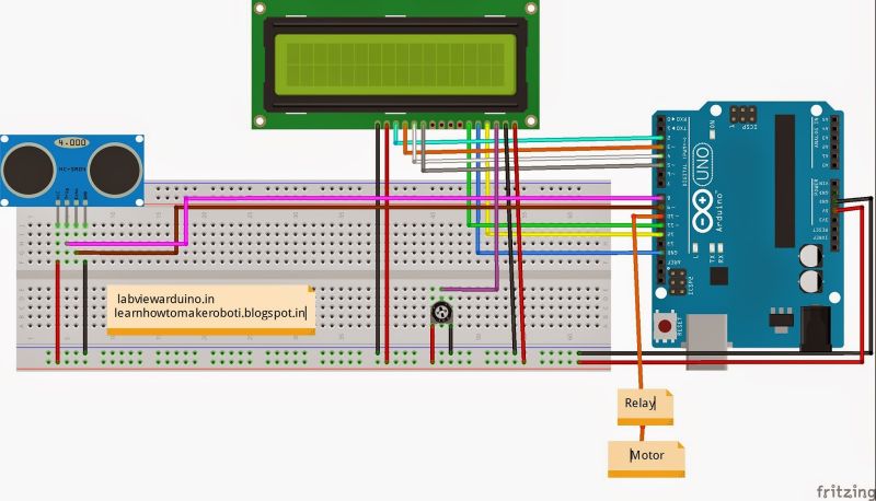

Elainedan0228
May 16, 2019
1
May 16, 2019
1
There are many ways like using a float sensor to determine the water level, or using probes to detect peak and low level in the tank. it is simple to use ultrasonic sensor which gives the depth, by determining the tank depth we can set the maximum and minimum level
hevans1944
Hop - AC8NS
Jun 21, 2012
4,986
Jun 21, 2012
4,986
Hmmm. @Elainedan0228, how does your "monkey see, monkey do" picture add anything to this discussion?
