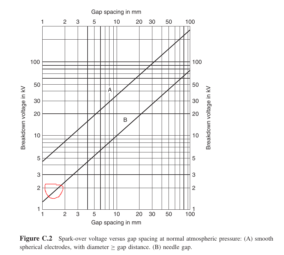

I checked the volts on it, its 586 volts, no matter what the input volts is.
they put 50,000 volts on the advertisement tho, absolute bullshit.
ratstar
Aug 20, 2018
485
Aug 20, 2018
485
Thankyou Bertus for the nice information as always.
But I doubt it, because its not sparking very far, I could make a video to show you, but its only a tiny dot spark its making.
But... I guess maybe it actually is in the thousands at least, its hard to say. yes, u might be right THANKYOU!

Hello,
Read the following PDF to estimate the voltage.

Hello,
What is the distance?
1 to 2 mm?

Doesn't matter if you short a transformer or a capacitor as far as I know, not that I know exactly what's in the thing.
But the power supply screen went blank when i was running it, I dont know what happened there.
circled the approximate distance.
