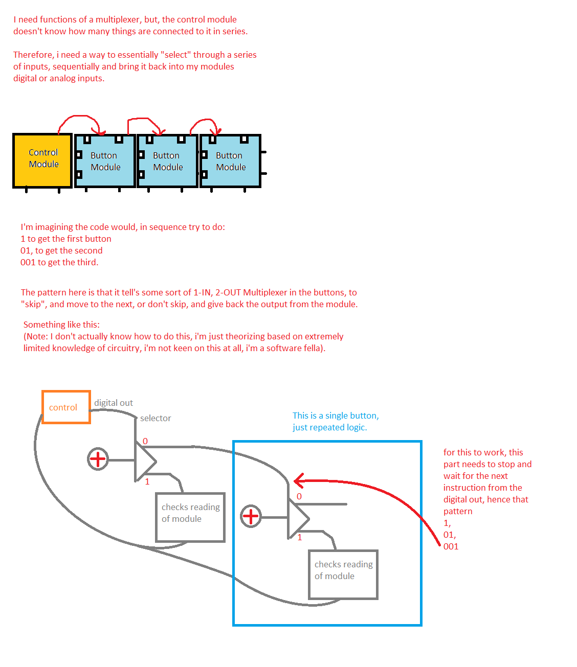

Hello all!
New to this forum so please excuse any formatting issues.
Anyways, here's a picture for starters:
FYI, I'm not an electric engineer, very little understanding of circuity apart from fundamentals.
I'm a code monkey :p
OK, if the picture wasn't descriptive enough of the problem.
I just want to essentially make a way to jump through a bunch of buttons that i connect to a "controller" module, without knowing HOW many of these buttons are gonna be set up in sequence. This means that i can't use the multiplexer, I COULD just forward all the outputs of the controller to each button, but i think it would be more efficient to just use a single digital pin on the teensy to figure out the states of all my buttons by performing some sort of logical loop in my arduino software.
Any ideas on how i'd do this?
Thanks!

I'm trying to make a modular sort of gamepad. Where you can attach a bunch of different modules together. (Buttons, Joysticks, Pedals, etc..)
As long as they're connected to a controller, the buttons outputs should be read in sequence they are connected (pressed or not pressed). However, it will loop through this sequence as quick as possible, and also tell the user if multiple buttons have been pressed (there will be a limit to the amount of buttons connected, which will depend on the speed of the loop).
I'm going to be connecting modules to it that will be giving back digital, and analog outputs which i'll be pushing back into the respective ports on my Arduino so i can issue the right commands to my PC.
My problem is trying to figure out what circuity i'd need in each button so that the Arduino can issue commands to:
  1. Traverse sequentially through each module
  2. returning what it's digital, or analog state is, depending on what kind of module it is.
  3. Needs to know what the traversal limit is, which will be indicated by the amount of these modules are connected (I was thinking of some switch that gets flicked when a module is connected to another, that tells the circuit if we're attached to something or not, which can tell the Arduino if we're at the end or not.
I want to try to do this with only:
1 digital pin: Digital Input (to read digital module data, buttons, switches etc..)
1 analog pin: Analog Input (to read analog module data, Joysticks, Pedals etc..)
1 digital pin - Traversal Pin: (to issue traversal commands to either skip the module, or to read it it's state)
1 digital pin - Dead End Pin: that tells the board if at the current module you're traversing to is at the end, or there are more ahead.
This way, in code:
I'd be telling the traversal digital out to output a 1, which gives me the first modules data,
then i'll tell it to output a 0, 1, which skips the first module, and tells me the second one.
then i'll tell it to output a 0, 0, 1, which skipps the first modulee, aand tells me the third one.
etc..
Or if there was a way that was simpler, i'd like to just:
tell the traversal pin to digital out a 1, it hops the first module and reads back itt's output
tell the traversal pin to digital out a 1 again, it'll hop to the next one, and reads back it's ouutput.
and on and on, only stopping the loop if when it reads a module, the digital "Dead End" pin as a 1.
I hope that was a beetter explanation, i'd edit my own post with this butt i don't see such a button.

The 'proper' way to do this would be to use a proprietary communications bus - like I2C or RS485 or even NMEA!! - and develop individual controllers (gamepads etc) that output to that bus.
With simple I2C comms protocols being possible in some of the smallest PIC-type microcontrollers there's no reason why this should be an expensive solution and actually quite easily achievable.
Where can i get one of these I2C capable controllers i can stick into each one?
Also, why would it more proper to do this, than something as simple as what i was proposing? I'd rather not implement additional microcontrollers in something as simple as what i want, but if that's whats necessary, and the components i need to buy are cheap, then i'm game!
kellys_eye
Jun 25, 2010
6,512
Jun 25, 2010
6,512
I2C is a protocol enabled in software and/or hardware and as such available as a 'sketch' for the Arduino range of processors - the Arduino range having the hardware built-in.
The ATtiny20 is the smallest (I think) with I2C built-in:
http://www.atmel.com/images/atmel-8235-8-bit-avr-microcontroller-attiny20_datasheet.pdf
but any other UART-capable device would provide a route to simple 2-wire comms.
Check out this tutorial on I2C and the links (lower down) to other resources
https://learn.sparkfun.com/tutorials/i2c
But if you implement I2C in the Arduino (whatever version) itself then you can also use the device to interface to the buttons, potentiometers, LEDs whatever that comprise your gaming devices/button modules etc. The Arduino - as a programmable module - is one of the cheapest around and the Chinese markets full of multiple-purchase cheap (CHEAP!) offers. The fact that the Arduino also comes with access to ready-written software modules makes development a piece of urine...
Here's an offer for FIVE such modules that work out at around $3 a piece.
https://www.ebay.co.uk/itm/NEW-5Pcs...314448?hash=item3d34787490:g:~gMAAOSwqYhZv41R
I couldn't recommend a simpler or cheaper solution.

OK, i did a bunch of research on these, and they look really promising and incredibly easy to program using a Arduino.
I guess i can use this chip to have pre-loaded code that can send out my final outputs, just like a sensor, to my master "Teensy" (which def has the SDL, and SCL pins so i can clock and send data), which can ask each one for it's information.
I guess my last 2 things would be:
https://www.digikey.ca/products/en/.../685/page/2?k=ATTINY&k=ATTINY&pkeyword=ATTINY
I am looking at this, and i really don't understand wtf to buy for my application that would be the cheapest. They're already pretty cheap, i just don't want something overkill to handle button clicks, and some potentiometers for joysticks, would be pretty silly to do anything with a ton of processing. The only thing i really need in terms of performance is high mhz because any delay on the inputs from the modules wouldn't be very enjoyable.
And my final question would be,
How would you go about putting these things together so that when a new one is added, my arduino would automatically know it's address in the I2C and start reading from it's data. Can i loop through all of the I2C's possible memory addressses that are connected?
--- EDIT ---
I did some more research on how I'd go about assigning the addresses. I heard of something called an R2R network, and the way these modules set their own address is by checking the input voltage, and using that as a seed to figure out it's own address. I think this works because each of these modules attached in sequence would essentially add resistance as it travels down?
If that would work, how would i go about telling the Arduino (The master), what the newly connected slaves address is?
BTW: I think i found one that's incredibly cheap, and more than suits the purposes:
http://canada.newark.com/atmel/attiny45-20pu/microcontroller-mcu-8-bit-attiny/dp/68T3729
What do you peeps think?
