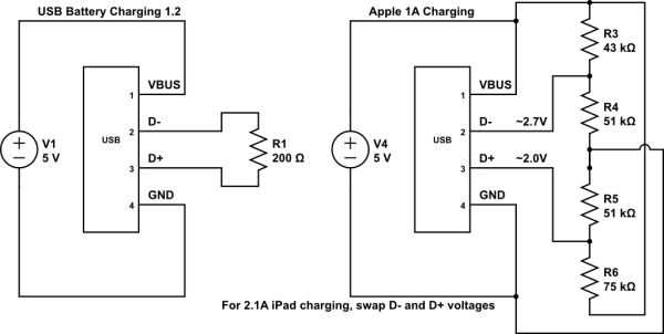

Alright, folks. I'm a beginner electronicist, and I'm hoping you Elmers out there can give me some advice.
I'm well and truly sick of paying ~$20 for USB chargers claiming to supply 2A @ 5VDC to my myriad phones, tablets, cameras, etc., but delivering 700mA on a good day. I'm sick of not being able to find something that will charge two phones and three tablets simultaneously. I'm sick of USB power meters cutting the current flow in half when I put them into the circuit. In short... MOAR POWWWAAAAH! So I decided to take matters into my own hands.
I want to build my own USB charger. I know about the the various data pin resistor schemes for the USB charging standard, Samsung, and Apple (at least I think I do). I bought a 5VDC 20A switching power supply from ChinaBay, and have some perfboard, USB-A PCB-mount jacks, and a volt/ammeter on the way. My intention is to keep it pretty simple... volt meter across the DC + & - terminals, ammeter in line before the DC - return, and about 4-ea android- and apple-spec voltage divider/resistor getups between the data pins on the USB jacks, all fed in parallel by the 20A power supply.
I've had a heck of a time finding other people who've done this. I can only assume other people aren't as obsessed with fast charging as I am. Regardless, I don't have any examples to follow! I've only found one (poorly documented) project remotely similar to mine and he didn't make it high-powered. So my question is this: what am I doing wrong? I'm sure there's something I could do better. The project linked above has what I assume are filtering capacitors on each port. How do you select capacitors for filtering (type and capacitance)? Are they a good idea? Do they go on the + or GND side of the jack? Will perfboard be able to carry 2A for a centimeter or two without any problems?
Am I completely nuts?

Could you post a schematic of what you are doing, this helps. If you have no way to draw schematics either get LTSpice IV, Yenka or draw it. And if you are trying to feed more current into devices than they are specified for it will most likely break the battery/overheat something inside the device.

I personally would use a filter cap, but am concerned with how you plan to wire in the required resistances on the data lines to provide more than 500mA to the devices you want to charge.

I puzzled my way through LTspice IV enough to make an ugly schematic (attached). Gryd3, I got the Android (USB-standard?) spec from various places around the XDA-Developer's forum which claim the standard for everyone but Apple is >200Ω across the data pins (Anandtech, below, shows it AT 200Ω). Other Samsung (tablet) specs seem to have varying voltage requirements on the data pins, in the same vein as Apple.
Got the Apple design from Anandtech
Lavaguava, don't all modern phones/tablets have intelligent, current limiting charge cycles? I've safely and successfully charged Li-Ion batteries manually, with just a lab power supply by following the charge guidelines listed on BatteryUniversity. The phone should take care of the constant-current part of the charge cycle anyway -- if it didn't, it seems like we'd have a lot more battery fires. And I've always been told that as long as you regulate voltage properly, devices will take care of the current themselves; e.g. you can plug a laptop into a 5A or 20A mains circuit without a problem, or plug a 12VDC fan into 9 AAs or a car battery. I know I've plugged 500mA USB devices into my 2.1A chargers and never noticed a problem. Same for plugging a 1A iPhone into a 2.1A iPad charger. Am I looking at this wrong?
That's not even wrong! The device will draw whatever current it decides to draw. The only way to force too much current into a device is to apply too much voltage to it (generally).
Lavaguava, don't all modern phones/tablets have intelligent, current limiting charge cycles? [...] The phone should take care of the constant-current part of the charge cycle anyway -- if it didn't, it seems like we'd have a lot more battery fires. And I've always been told that as long as you regulate voltage properly, devices will take care of the current themselves; e.g. you can plug a laptop into a 5A or 20A mains circuit without a problem, or plug a 12VDC fan into 9 AAs or a car battery.
That's right.
Sounds like a good project to me. It's a good idea to have a separate polyswitch on each connector, in series with the feed to the +V pin. A decoupling capacitor (e.g. 1 µF 50V X7R ceramic) from +V to 0V on each connector won't hurt, but not likely to help either.

Perfboard can carry the 2a just fine, its the size of wire you choose to put across the perfboard that matters ;) A piece of insulated 22-20 ga should be ok for that load (23g will get it done but not much of a safety margin). I can't offer you any further advice, but I did come across some interesting reading material - see post three in the attached thread. Also see some links left by Kris. Happy developing!
