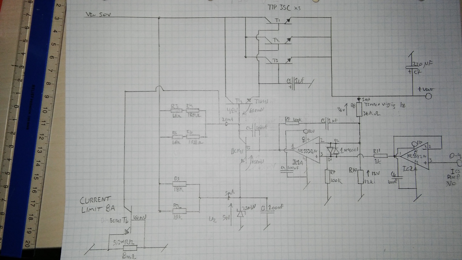

Damn, you guys sure have been busy, I almost feel bad for just jumping back in.. :)
Well since you guys are still around, I got that digitally adjustable frequency working using a digipot, im now trying to move forward with the project and the next step for me is digital output control of my PSU.
With a ton of inspiration from various sources..
But just like so many things in electronics, i've never tried this kind of regulation before either, most i've tried before this is actually just a potentiometer on the base of T5.. Would this kind of circuit work do you think?
I've only done simple op amp circuits before this, so it sure is quite the step up..
The input on IC2A is comming from a DAC IC, which is controlled by my MCU, the other side of IC1 and IC2 will be used as comparators elsewhere in my induction project :)
As always, thanks guys!
