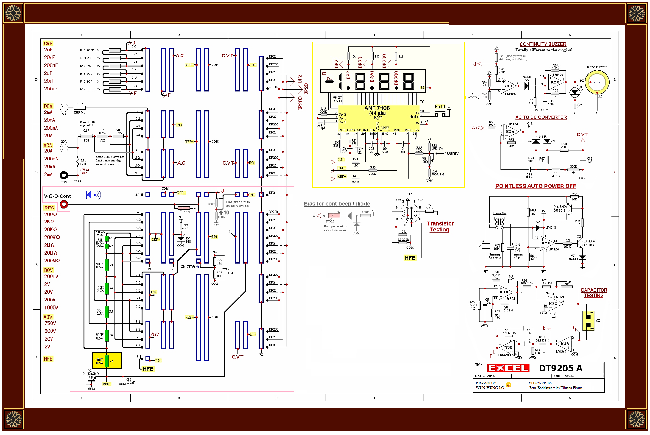

Hi. I have problem with DT9205A. What,s the value R7?
73's de Edd
Aug 21, 2015
3,730
Aug 21, 2015
3,730
Sir zizu . . . . .
The instruments design has a series string of voltage divider resistors . . . . which I have marked up in GREEN . . . . with your R7 being at the bottom of the string for being the 200 MV range function .
Reference to the bottom left corner of the schematic . . . . . closed in Black / Yellow box.
According to my latest schematic. that would be a 100 ohm decimal 5 % tolerance, and judge the wattage by the physical sizing of the nearby R6 connected to it.
Next time " THIMK " ! ! ! ! so that you never end up with upwards of 1,000,000 millivolts being at your meter probes tip, whilst the range selector is set for but a mere 200mv.

Another drawing in the same zip(DT9205A cleaned up dot gif) shows R7 (green) non-existent and different numbering and value.
i.e. shows it in place of R9 (220K)
Bluejets
Oct 5, 2014
7,374
Oct 5, 2014
7,374
This video, apparently no semi is installed in that location.
0:54 in the video.
Appears to be several variations on the same model number for schematics.
