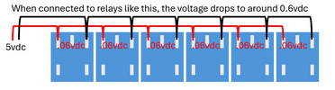

Hi. I have a project where I'm using 6 5v pcb coil relays so that one power source will switch all 6 at one time. I usually use the pre-made boards but have a space constraint so I thought I'd be able to just use the switch coils by themselves. I tried one and it worked fine so I wired up all 6 and things got a little nuts. The relays would not switch and my volt meter was reading around 0.6v where the supply voltage was a little over 5v. I'm clearly doing something wrong but not sure what that is. Any guidance would be greatly appreciated.

Place coils in parallel, use a power supply sufficiently sized for all 6 coils (plus about 50% margin to allow for inrush current).
No idea where you are measuring power or how your connections are made so supply a photo and a pencil sketch of everything.

What PIN numbers are you connecting to?.
Perhaps you have a current limit set too low for 6 coils on your power supply?

This is correct way to wire these for operation off 5V.
Your nominal current is ~90 mA / relay, so 450 mA required by supply.
What exactly is the supply, eg. schematic ?
Note there should not be an inrush current per se as they are inductive in
nature, question is are they low Q so current transient pretty damped....
But there is a minimum V, I needed to get them to turn on. And then holding
V, I is lower.

That all makes sense to me. The power supply is a OneSpot, so, 9vdc 1700mA. I have it passing through a voltage regulator that drops it to about 5.5vdc. I had the negative tied to the regulator and the positive coming from pin 9 on an an Arduino Leonardo. Maybe, as noted by Martaine2005 the pin can't push enough voltage to it?

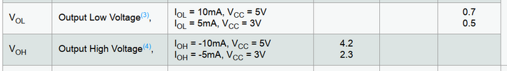

Hello,
The relays can not be driven by an arduino pin.
You will need a buffer between the arduino pin and the relays.

You have to read datasheets and their pin ratings to succeed at designs.
From the data sheet look at pin and max allowed current in the MCU supply
rail ratings :

One correction to the earlier post, since you need to drive ~ 450 mA,
a 2N3904, 2N2222 not adequate as the base drive to get the transistor
is ~ 45 mA, too much for the MCU GPIO pin.
Either use a logic level MOSFET (preferred) or a darlington TIP type transistor,
either in a TO220 type package. Say 60 - 100V breakdown to give you plenty
of margin.
