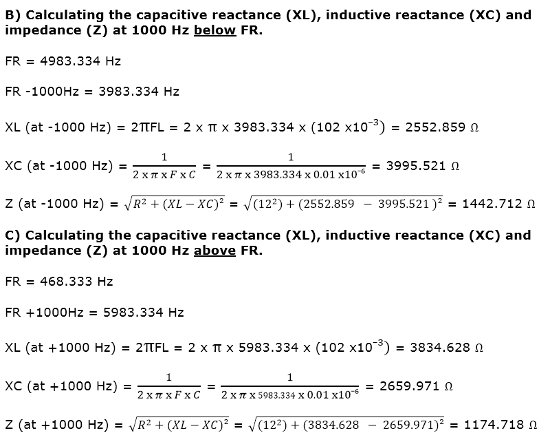

Hello everyone! Thank you for viewing my question.
I have an assignment question and have completed all of the questions and I am satisfied with my results. The issue I am facing however, is the 'build your circuit on Multisim to verify your answer' part.
My given values for this task are:
Vs = 14 V
F = 50 Hz
R = 12 Ω
L = 102 mH
C = 0.01 µF
I have calculated FR using the following method:
Have I used the correct method? And how can I measure this in Multisim to prove/see if my answer is correct?
Thank you!

The method is correct but your answer isn't.
You entered the wrong numbers for C=0.01e-6

Thanks for replying, you are right! I didn't notice that, I've done it as 1x10^-6 instead of 0.01x10^-6 Thanks! I'm just going to put that down to a 'middle of the night brain fart' haha. I've corrected my work throughout, still not sure how to display the RF in Multisim though. I did it once last year but it was so long ago I don't remember what to connect or how to connect it.
Your method is correct, as are your updated results, even though in (C) you have FR = 468.333 Hz but used the correct value in the calculations. Now calculate XL, XC, and Z at the resonance frequency.
I am "pretty sure" Multisim will allow you do a frequency-sweep simulation. Just set the sweep limits a few percent below and above the calculated resonant frequency. Measure the voltage across R, which will be an indication of the current in the circuit. The width of the peak will be proportional to R, small R => smaller width. This proportionality is called Q (for quality, historically) and represents the power lost in R versus power applied to the series RLC circuit at the resonant frequency.
