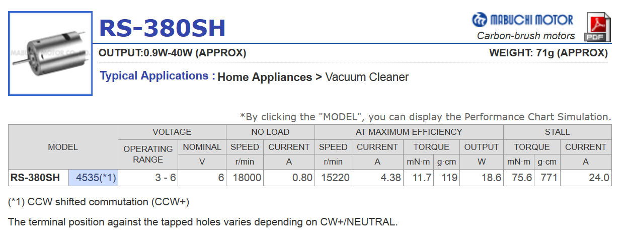

Well yesterday i was testing my Robot Truck it didn't move at first until i increased the speed to the maximum it started moving for 5 seconds then my encoder smoked after that happened i didn't understand the meaning of stall current until then so here is what the data sheet look like:
I did drive using a this encoder :
Which smoked the maximum output amp was 4.5A
Can you help me guys choosing the right motor driver ?
and can i use a 2A H-bridge + a relay to drive this motor ?
Thanks.

It is very simple. You need a motor controller that can handle the stall current.
Bob
